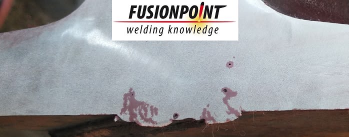

@ Tug, btrueblood: We're welding heavy crane rails in situ. Think about 1" open groove.
The groove in the backing needs to be significantly wider than that, and deeper than standard because it's a heavy slag wire that needs to go somewhere.
@ sbisteel, we're seeing cracking in the bottom layers from copper pickup. We're welding slow and with high amps.
Using thicker copper bars or water cooled blocks isn't working, some of these are 100 ft in the air. And we can't lift the rails high enough to slide 'em under.

Copper is useful provided you do not have direct arc impingement. That's why it works well for the electroslag process.
The problem with hard ceramic chips is that the joint needs to be very precise and consistent along its length.
I fully agree, however copper is in many cases the most convenient material to work with.
Here's however the result of welding on Cu (small cracks are made visible using red dye):
