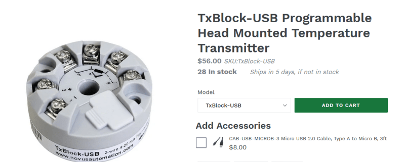

Do you have space adjacent to the 9 pin connector to install a loop powered, temperature compensated, temperature transmitter? Then you may use the wires in the hose to transmit a robust 4-20 mA signal.
Some temperature transmitters are quite small.
Example:
Link

Thank you for your continued support. Waross's idea of using a loop powered, temperature compensated, temperature transmitter at the location of the 9-pin connector and sending a 4-20 mA signal back through the copper wires in the heated hose sounds like a great way to get better accuracy while avoiding the more difficult task of replacing the thermocouple in the Applicator with an RTD.

The transmitter that I suggested may also do RTDs.
Another option may be to mount a thermostat to the metal block and send an on/off control signal back to the panel.

I do like the small 2 wire transmitter option though; it uses copper wire by design on the 4-20mA signal side.
