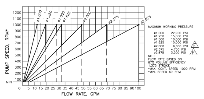

The client wants to change cold ends from 1,625" to 1,25" on 901-01966 ICP-200 pump.
It seemed logical to me that this will change SCFM output. However, the equation my former collegue used was 3xRPM and this would imply that SCFM is independent of both pressure and temperature.
From the data chart of the pump, flow rate:pump speed is a linear function. We can write Flow Rate (GPM), as a function of RPM.
For Ø1.625 Cold Ends: Flow Rate (GPM) = 0,032*RPM
For Ø1.250 Cold Ends: Flow Rate (GPM) = 0,019*RPM

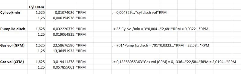

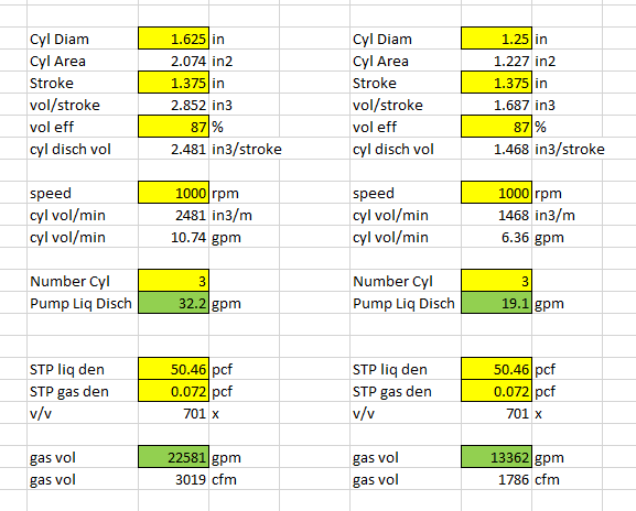

I made a spreadsheet for you.
Pump discharge = cylinder volume x number of cylinders x rpm x volumetric efficiency
cylinder volume is 1/4 pi D^2 x stroke
volumetric efficiency 0.87 per your pump chart. A volumetric efficiency 0f 0.87 indicates that the stroke does not empty the cylinder completely. There will be 13% of the cylinder volume that will remain in the cylinder.
The pump will give you the calculated discharge up to the max pressures as per your chart. The pump apparently runs out of sufficient power for each cold end diameter at the pressures indicated.
DON'T USE THIS SPREADSHEET ATTACHED HERE.
GAS VOLUME IS GPM, NOT CFM.
I CORRECTED THE PICTURE, BUT CAN'T SEEM TO CORRECT THIS SPREADSHEET LINK.
THE CORRECTED SHEET FOLLOWS.
1503-44 said:
Use this spreadsheet.
The other one has the wrong gas volume as cfm, but it is gpm
This one gives both like the picture above.
Gas volume is standard US gallons and standard cubic feet.

After going through the spreadsheet, I now understand how the calculations should have been made.
Defining Gas vol(cfm) in terms of RPM should then be:
3,0194...*RPM for 1,625 cylinder diameter
1,7865...*RPM for 1,25 cylinder diameter
This proves that assumption 3*RPM that my collegue made was correct and that the value of SFCM is changed with piston diameter.
