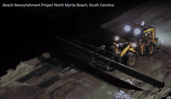

Another way to look at the problem is to consider the ground contact pressure of tracked vehicles that are successful under those condition. The video shows large Caterpillar bulldozers. From the specs for a Caterpillar D9 Bulldozer:
Operating Weight = 110,225 lb.
Ground Contact Area = 45.6 ft2
Average Ground Contact Pressure = 110,225 lb. / 45.6 ft2 = 2420 lb/ft2
The video also shows a wheeled loader working successfully. The beach renourishment saturated sand allowable bearing pressure must be somewhat greater than 2420 lb/ft2

Hi Slideruleera,
Many thanks for your respone, appreciated.
Yes I had conceived the same approach. However, I don't know what safety margin I am at and also our load will not be equally distributed.
Hence, I was hoping for some experience numbers.
Anyway, many thanks for your input.
With kind regards,
Peter
You will need to contact a local contractor who has done similar work in the area. It based on experience along with trial and error ie if they get stuck then time to get the chains out. Also any good equipment operators will know the limits of the equipment.
To be clear, saturated sand is not the same as submerged sand. Sand on the bottom of the sea floor is being subjected to buoyancy and the weight of water above.
