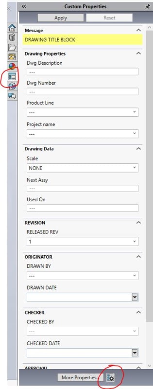

I can edit part custom properties via an assembly BOM. Is there a way to do this to drawing custom properties?

The best way to create/edit custom properties for ALL objects: parts, assemblies and drawings is thru Property tab.
The preparation work is required: You have to create Property tabs using Property Tab Builder utility. Check help/tutorials available to you.
Yes, I understand it's usually done at the part level. Sometimes I use an assembly bom off the sheet to view or edit properties of the components cause they're all right there in a table. It so happens I put the checker and checked date properties on the drawing instead of the part is all.
Create a dwg custom property file. Have each dwg template link to it.
Trying to do it via a BOM or table is more complicated.
I would regard the checker and checked dates as part of the drawing, and I would regard the drawing as the proper place to edit these.
If you are editing part model metadata from some external resource like a fabrication drawing, assembly model, assembly drawing, or an external BOM, what happens when your model is read[‑]only? My experience is that SolidWorks will do the edit in RAM, but the file on your drive will not be updated.
I think SolidWorks will let you edit fields in the BOM such that they become different from the model's metadata. These edits will not survive somebody deleting the BOM and re-inserting it. Re-insertion is a quick and dirty way to solve BOM problems, and I normally do not hesitate. Editing BOM fields is very, very bad practise.
JHG
Thanks ctopher I'm gonna look into that.
