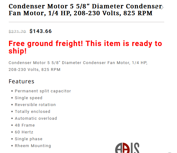

The motor is a CF-9622:
Can we tell if that has a centrifugal switch?
I could easily test the capacitor - I think - just by measuring the resistance change, and by verifying the capacitance with a DMM?
Thanks!
It is easier to just replace capacitors. They get leaky (electrically) and can give you all kinds of odd readings.
Permanent Split Capacitor, no centrifugal switch.
With a blown capacitor and a little back draft on the fan, this will start in reverse.

Checking the capacitor in question, yields no reading on a DMM capacitor meter. Also yields infinite resistance instantly and not changing over time, in both directions.
