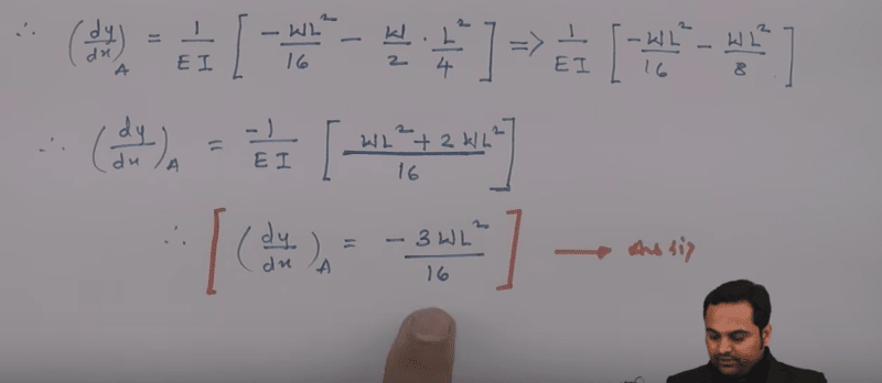

Macaulay's Theorem is just another name for the Double Integration Method. I was going to refer you to the following for a simple example of a beam with a point load at midspan. Unfortunately, the man in the video gets the expression for dy/dx (slope) and y (deflection) wrong. Can you find his error?

Correct, although there are similarities in the equations, some having additional terms accounting for different ranges. That point was missed by the instructor in the video which I mentioned earlier. He used the wrong expression when finding the slope at Point A and came up with the wrong answer. (see below)
Although he came up with the correct answer for deflection at midspan, his expression for deflection was not valid for the left half of the beam.
