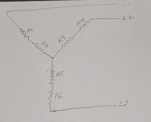

I have a tank that is used to melt glue. It has six heaters, each with a resistance of 10 ohms. It is powered with 208 VAC three phase.
Originally, it was wired as shown below with two heaters in parallel across each possible pair of lines (L1-L2, L2-L3, and L1-L3)...
I had asked a question yesterday about how to calculate the total current that this circuit would draw from L1, L2, and L3, which turned out to be about 72 amps. It turns out that this exceeds the rating of the breakers I have available to feed this circuit. With this being the case, I considered rewiring the heaters as shown below to reduce the current draw ...
... When I did the same current calculations (if I did them correctly), this decreased my expected current by a factor of four (down to 18 amps). This would make it easy for me to find a breaker to serve the circuit, but I am afraid that the corresponding factor of four decrease in heating power might make me unable to melt glue at my required rate.
I am wondering if anyone here can suggest another wiring alternative that would allow me to decrease the current draw by a factor that is less than four while still keeping my load balanced and having the same current flowing through every heater. I though about simply eliminating three heaters so that I would only hava a single heater across each possible pair of lines (L1-L2, L2-L3, and L1-L3), but I don't like this idea because it would mean I would then have less heated surface area in contact with the glue. I would really like to have current (albeit reduced) flowing through all six heaters. With six heaters and three lines, I just can't think of a way I can do this other than how I show in my second diagram (which results in a 4x reduction in power).
Any suggestions will be greatly appreciated.

"... It has six heaters, each with a resistance of 10 ohms. It is powered with 208 VAC three phase. Originally, it was wired as shown below with two heaters in parallel across each possible pair of lines (L1-L2, L2-L3, and L1-L3)..."
1. I am thinking by connecting [R1, R2 in series]; [R3, R4 in series], [R5, R6 in series]. Connect R1 to L1, R3 to L2, R3 to L3. Connect R2,4,6; in Y formation. This formation will result to [the lowest current] but check whether the heat produced (wattage) is sufficient to melt the glue.
2. Alternatively, R1, R2 in parallel, R3//R4, R5//R6. Connecting to the L1,2,3 ; in Y formation. This will produce more heat or higher (temperature).

Hi Che -
Thank you for your suggestions. For the two options you mentioned (which I repeated below in italics), can you please let me know if the sketches I have inserted beneath each one accurately reflects what you have in mind? ...

Dear Mr. PaulKraemer (Electrical)(OP)5 Aug 21 17:23
" ... For the two options you mentioned (which I repeated below in italics), can you please let me know if the sketches I have inserted beneath each one accurately reflects what you have in mind? ... "
" ...1. I am thinking by connecting [R1, R2 in series]; [R3, R4 in series], [R5, R6 in series]. Connect R1 to L1, R3 to L2, [highlight #CC0000]R3[/highlight] to L3. Connect R2,4,6; in Y formation. This formation will result to [the lowest current] but check whether the heat produced (wattage) is sufficient to melt the glue...."
My apology, there is a typo error. It should be...Connect R1 to L1, R3 to L2, R5 to L3. I noticed you had got it right. It was my mistake that had caused the confusion. I am sorry for the inconvenience caused.
2. The second drawing, with resistors in parallel is in order.
Che Kuan Yau (Singapore)
1. There are numerous ways of connection the 6 resistors (heater). They can be connected in series, parallel, in Y , D or YD formation etc.
2. I tried to work out four basic connections based on the resistor each rated 208V 10 Ohm on a 3ph 208V source.
2.1 in Y formation:
a) 2 resistors in series (10+10)=20 Ohm.
Line current = 6A . Total power of 6 resistors = 2161.5W
b) 2 resistors in parallel (10//10)=5 Ohm.
Line current = 24A . Total power of 6 resistors = 8647.2W
2.2 in D/b] formation:
Line current = 18.01A . Total power of 6 resistors = 6488.21W
Line current = 72.05A . Total power of 6 resistors = 25958.4W
3. Observation:
a) No matter in Y, D or YD formation, resistors in series or in parallel connection; the (line current) is proportional to the [heat generated].
b) The (electricity bill) is proportional to the [heat generated].
