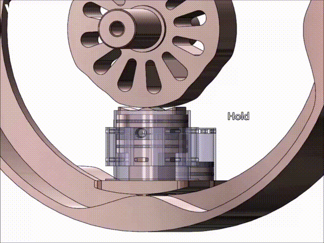

Seems quite complex and has a number of seals and moving parts?
Can't see how this works exactly as there isn't an animation or steps of the phases.
Is this just a design or has it been built?
What do those cylinders do that are moved by the cam?
Basically I can't work out how its supposed to work from one diagram.

Sorry, I thought everyone here was already familiar with the engine concept and was just soliciting comments on the new fuel injection scheme.
Below is a simplified animation showing the cycle, and the attached document describes the design decisions behind the design.

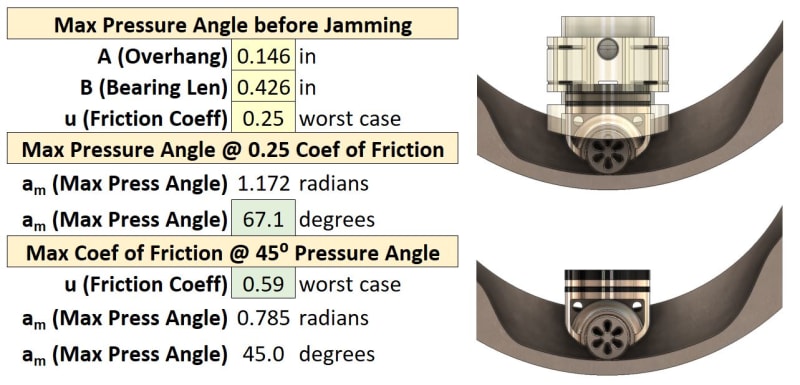

Below is my cam with the new rolling follower piston (with and without the cylinder liner) and the calculation of maximum pressure angle.
Note that B = 2.9A (exceeding the 2A recommendation), the piston to cylinder clearance (backlash) will be 0.001 inches, and all components are made of Maraging 350 steel.

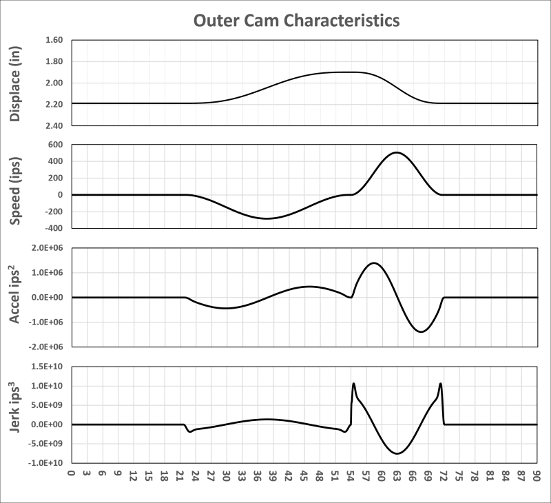

My current cam design, shown below, has 30 degree pressure angle on rise (compression) and 45 degree pressure angle on fall (expansion).
Note this is a new profile constructed using a cycloid waveform for acceleration followed by derivation of speed and displacement.
The new method, recommended by a reviewer in another forum, has smooth acceleration and finite jerk.
It turns out I "stumbled" into the proper cam design in regards pressure angle (shallow on rise, steep on fall) by assessing mechanical efficiency (when the cam is driving, pressure angle should be as shallow as possible, but when the follower is driving, it should be as steep as possible) and stress (overhang should be small and the support length long). It is rewarding to see those mechanical analyses yielded a design that complies with accepted cam design practice. I also "stumbled" into a bad method for calculating the profile that resulted in excessive jerk, however, so I'm very grateful to the peer who spotted the error and recommended a course of action that resulted in a better design.
With textbook references substantiating the cam design, I'm done questioning its validity.
I'm now off to confirm peak loading under dynamic conditions is within the margin of safety.
