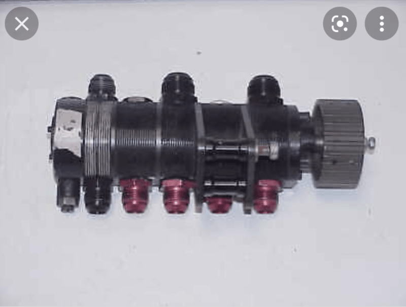

I would like to know if anyone out there knows how to plumb a valve spring oil cooler.
Are they gravity activated, do they need a pump like for gearboxes and diffs?

I am stumped also. Earl's Mocal and SETRAB all seel "valve spring oil coolers". Comp did not have an answer either. I have been in racing and performance for over 40 years and I too have never heard of such a thing. The idea may not be so bad when one considers that the valve springs on a race engine can get red hot and they eventually will need replacing. I would guess that when the springs get super hot they lose some of their tension and can cause power loss. There, it seems that cooler oil would be beneficial for performance and longevity.
Try "Valve Spring Oiler" for more information. It's additional oil flow directed at the springs for cooling in engines that operate at extended high speed.

I was going to mention that Mopar and KE Performance sell valve covers (or devices that sit under the cover) with integrated valve spring oilers that direct a spray onto each individual spring. I didn't because a spray device like that needs pressure, and folks should be very careful about tapping into the oil pressure of their engines unless they know what they're doing (and someone asking how to plumb one probably doesn't).

Think about a pushrod v8 in a high performance marine application. The type that are running 3/4" lift at 5000-6000 rpm for tens of minutes at a time. NASCAR would be a an even better candidate. Both of these are going to be dry sump engines with multi-stage pumps that can dedicate a state to bearing lube, piston cooling, valve spring cooling, etc...
However, OP, there is no performance benefits to valve spring cooling. The extra oil flow required is actually a parasitic loss. You should only consider this if you're experiencing valve spring failures.

If you look at high performance high endurance engines they often have staged oil pumps. They may have 5 or 6 oil pumps all driven along one shaft. One or more for scavenging, one for bearing lube, one for piston cooling, etc...
In such a case, the top end oiling can be independent from the rest of the engine. The drain back holes in the head would need to be plugged. With a closed loop oiling system for the top end you would now need a "valve spring oil cooler".
You are speaking of dry sump systems as used on most if not all endurance racing engines.

If I had carefully read the original post I'd have asked - how do you think oil will be forced through a radiator/heat exchanger? Pretty obvious that it will require a pump. And I think that's what was misleading - no one could match the idea that that isn't obvious a pump is required to the question as asked.
I used a picture of a dry sump pump because it shows an example of a pump with multiple pumping circuits. In your case, one would be dedicated to the valve spring cooling circuit.
