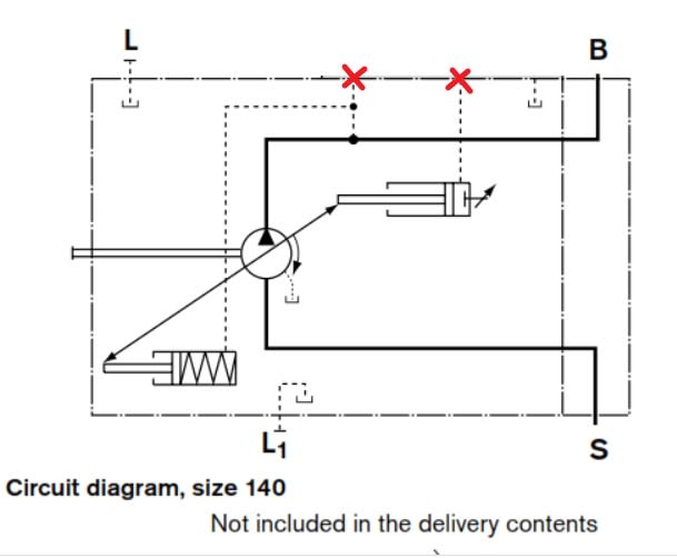

I have a Rexroth AA10VSO Series 31 hydraulic variable displacement, axial piston pump (please see attachment)
The reason I want to convert it to fixed displacement is because we don't need any variable output anymore. we will have a mechanical softstart for the hydraulic.
Also we need to reduce numbers of electrical control on our system.
Sorry, I'm not an expert in hydraulic. My question is how can I energize the pilot pressure? below is the snapshot from the datasheet.
Below is a snapshot from our existing hydraulic system and items in red circle are the control manifold which we will eliminate. can i just introduce a tee after 'LR'. one outlet to the 'x' (with pressure limiter) and the other outlet to the system?

Currently the pump is a variable displacement with electrical proportional pressure control. In other words, it will swivel down when the pressure setting is reached.
You should be able to remove the electrical proportional valve and plug the line to the pump since there is still a DR regulator as base.
It will then still be a variable displacement pump but the pressure setting will now be fixed and can be adjusted on the pump regulator.
Another option if you are in doubt is to simply replace the electrical proportional valve with a mechanical one.

A system with a variable displacement pump has a directional valve system with a closed center. IF you want to convert it to a fixed displacement pump you will need a directional valve with an open center so the entire pump flow can be dumped or by-passed to the tank when no hydraulic function is needed. When flow is directed to a function/actuator the pump will stay in max flow till it reaches the "cut off" pressure setting of the pump compensator.
You say you "don't need a variable flow anymore"?! Does that mean you are also rebuilding the system including the directional valve system?
If you energize the pilot pressure the pump will de-stroke and deliver zero pump flow.
Converting to fixed displacement is going to increase the fluid heating substantially. Be sure you're system can handle the extra heat input.
This is how the pump manages the pressure with the compensator
Disconnect the compensator and plug the ports/holes in the pump housing and the pump can't destroke
I don't think OP wants to convert it to fixed displacement, if you read between the lines he just wants to get rid of the proportional pressure control as that is no longer needed.
