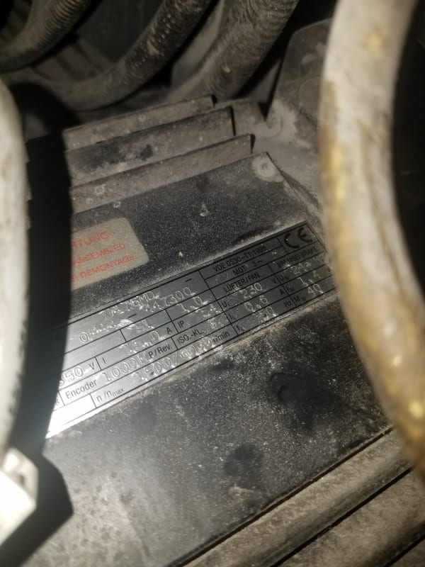

Single phase, no vfd, no capacitor, no data for HP attached is pic of data plate the portion shown is for cooling fan motor.
Chuck
Okay.

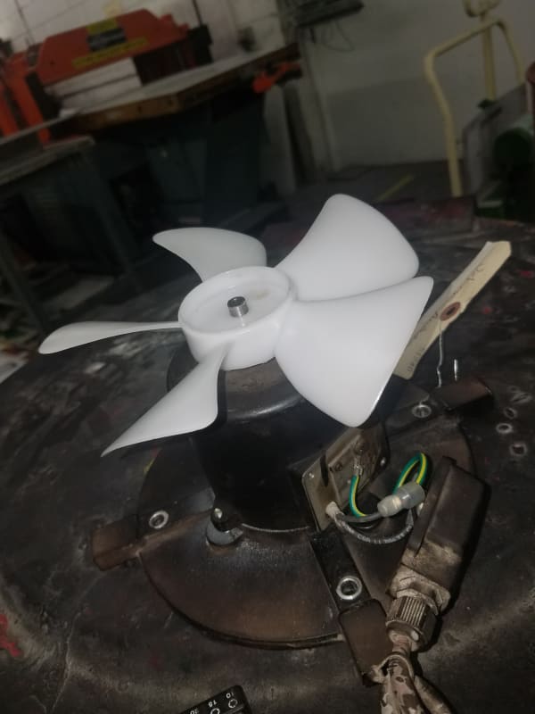

Which motor is within the scope of the discussion?
The motor pictured with the clean fan blade, or the motor shown with an aluminum stator housing?
John
I'll put in a vote for the rotor being off axial center with the stator.
That may cause a loss of torque and an end thrust that nay be causing some binding.
This may be a shaded pole motor and not have much starting torque at the best of times.

I can't see how many leads come out from the motor and how they are connected to a single-phase network (or two-phase)?
The motor plate states that the motor is three-phase. What about that?
Yes three phases 230 VAC 50 Hz and a break 24 V ?? and a encoder [ponder]
/A
Albert Einstein

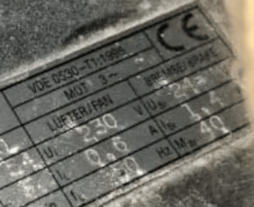

There are two nameplates. One on the left is for the 3-ph main motor 550 V (?) 1500 to 6000 RPM run by VFD with an encoder and hence the need for an external cooling fan driven by its own single phase motor, whose nameplate (220 V, 0.6 A etc.) is on the right. OP in his first post mentioned it's the cooling fan motor he has problem with.
Muthu
The plate isn't fully visible.
The right side of the plate it says
Motor 3 ~ phase
(Lufter) Fan, 230 V, 0,6 A, 50 Hz
(Breamse) Break, 24 V ??, 1,4 A, 40 Nm
There is nothing indicating on the plate that it is 1 phase.

3-ph shown is for the main motor driven by VFD.

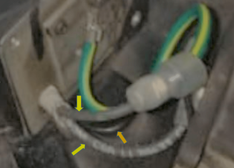

Going by two black supply wires, the cooling fan is single phase.

Not sure if what can be seen on the picture is two cables or three.
If the orange arrow also is a cable. [ponder]

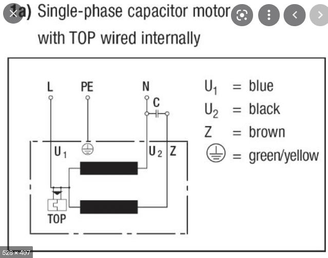

But OP sade it was two, but without a capacitor it wouldn't work, but maybe it is placed inside the fan motor so it can't be seen?

Redsnake, there is a three lead set for supply but one wire not used (not my design) good observation though. Edison, this particular Drive pulls paper off of a web roll so while motor is idle the brake keeps tension on paper. Bill, I have installed a lot of motors this should have been plug and play,we are sending it back to shop.

If that picture is from after the rewinding, maybe that is where the capacitor was suppose to go.
Have a hard time seeing how they could have missed it though.
