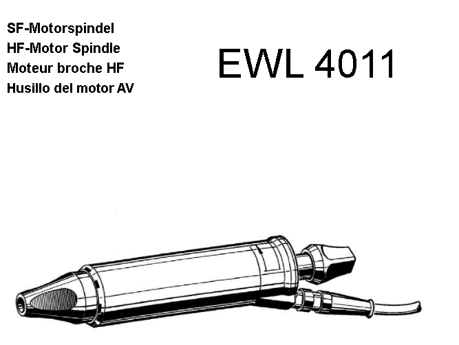

We need to fix that. The stator of a very old micromotor for dental laboratories was defective.
Fortunately, only one of the 3 terminals lost contact. That has been fixed and the motor is now working well.
As can be seen, it is a three-phase motor powered via a VFD for speed control up to 50,000 rpm. Probably it is 2 pole, 3-phase winding. The number of slots could be 3 or 6 or more.
But I wonder how to disassemble such a motor? Probably I need some special tools.
Does anyone have experience with this?
What does the rotor look like? What are the bearings like because the motor runs very quietly?

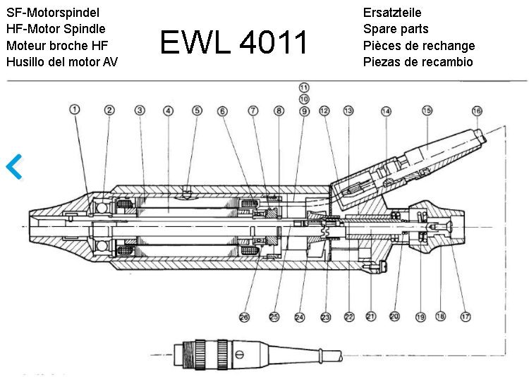

Look for a set screw, item 5 in RedSnake's graphic.
The motor may be assembled with interference fits and crimped joints. It is possible that it may only be destructively disassembled.
I see one deep groove ball bearing piece #2. I don't see any bearing on the other end. Maybe it's just some kind of sleeve / bushing on the other end (?)

Nice find on the motor cutaway, Anna.

Nr. 6 is also ball bearing. They could be the ceramic type.
That diagram is not of the OP motor.
