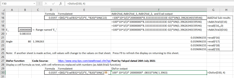

Here's my favorite UDF, it shows the numbers behind the variables in excel formulas.
Option Explicit

Saving functions in a module and uploading the file makes a cleaner forum post.
Yes that looks like it would be a useful way to document both the formula (FormulaText / getformula) and the values of the input variables (yakpol's DisFor).
I wonder how hard it would be to put all numbers into a common format, like scientific with 2 decimal places.

The numbers displayed have the similar format to referenced in the formula. In addition, the second argument (optional) limits precision. Like disfor(A1, 3)
Aha, you're way ahead of me. I didn't look close enough. Thanks.

One more thing. Disfor() requires these two functions to be placed in ThisWorkbook module, they help to keep screen and print updated.
[tt]
Private Sub Workbook_Activate()
Application.CalculateFull
End Sub
Private Sub Workbook_BeforePrint(Cancel As Boolean)
End Sub
[/tt]
Also, extensive use of this function slows down the worksheet, especially when running VBA routines.
