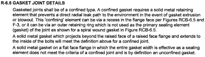

Good Morning,
Yes you can use ANSI RF or WN flanges on TEMA R units. However, the gasket must be contained per TEMA R. So the gasket must have outer and inner metal reinforcement rings.
This is out of TEMA 10th Ed.

As these are BEU style heat exchangers, you're going to have a pass partition plate in there somewhere.
Take a read of Paragraph UHX-4(b), you may have a hard time using standard B16.5 flanges.

You can still use ANSI flanges on both sides even if there are partitions. Purchasing ANSI flanges is cheaper than designing your own and machining your own flange.
r6155... 50%, no way....considering shop rates for machine time etc.. it evens out around 18-20 NPS flanges.
marty007, You can still use ANSI flanges and add a partition plate per UHX with a ANSI flange.
We do this stuff every day :)
Because there's a pass partition you aren't permitted to simply use the ASME B16.5 pressure/temperature ratings, you would need to run calculations per Appendix 2 of ASME Section VIII. In many cases standard B16.5 flanges fail Appendix 2 calculations.
