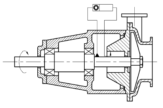

Which would be the phisical procedure to validate/measure the concentricity of a shaft into a hub like the ones of the picture:
As it can be seen, I can't use the external cylindric wall of the hub because it is conical and, let's say, it has a low quality surface finish.
This eccentricity would come from the fact that the hub is part of a subassembly and the shaft comes from another and, once assembled, the circular clearance in between is finally filled by a precise or fragile part that implies certain concentricity between the shaft and the hub to be validated before.
Thanks in advance.

Maybe this picture will be more understandable:
As you can see, the diameter of the shaft and the bore is not the same, but concentricity is needed as the mechanical seal has to be assembled there. The measurement should be done after some minutes running to see that the shaft/bearing/etc have not suffered any problem.

If the pump shaft runs true in relation to the bearing frame female spigot and the pump case male spigot and stuffing box were machined in the one set-up which is the norm, the pump shaft will be concentric with the stuffing box bore.
This is normally handled at the design stage by finding the limitations on the candidate seal for runout of the shaft to the seal housing and then allocating that allowable variation to tolerable variation (tolerance) among all the other parts, realizing that some of that allocation will by selecting suitably precise bearings. Since it is an overhung shaft there is a multiplier effect for each bearing's contribution via runout and clearance. That multiplier will be different for each bearing as each has a different amount of leverage.

The measurement you are describing is one that we take many times every day. The size of your seal chamber and shaft will dictate what sort of dial indicator will work the best. In order to be able to take this reading on a small pump I would get a last-word dial indicator and attach it to the shaft using a simple hose clamp. I would read the run-out of the seal chamber bore in a full sweep. The concentricity would be calculated by taking the total indicator run-out and dividing it by two.
The pump manufacturers will always claim that their pump is well designed and manufactured to meet their specifications. It often is not. We regularly find this concentricity is poor and we correct it in our shop.
In addition to measuring the concentricity, you should measure the perpendicularity of the seal chamber face to the shaft. You can do that with the same dial indicator reading against the axial face of the seal chamber.

If I have understood you well, the way is to put your reference to the shaft by attaching the dial on it so your measurement will be the relative between the shaft and the bore. I expect to have Ø25, Ø35 and Ø45 on my shafts so, is there any clamping accessory directly able for these diameters?? The bore will be Ø47 for Ø25 shaft (radial clearance: 11 mm).

I would use a standard hose clamp to attach the indicator to the shaft.
If you are concerned about scratching the shaft, wrap it with masking tape.
There are chain brackets designed for mounting dial indicators to a shaft. Starrett makes some very nice kits for this.
