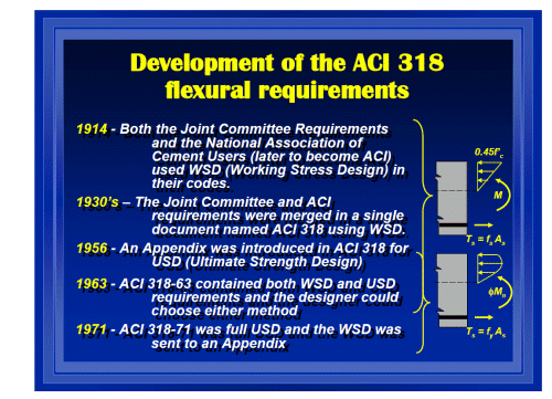

If you are doing a lot of work with old concrete buildings, you should download a copy of ACI 318-63, which is the last code to permit WSD (Working Stress Design). It also includes USD (Ultimate Strength Design). The document is in the public domain and can be found at the following address:
In particular, you will be interested in the following pages, but you may find other portions of ACI 318-63 helpful.

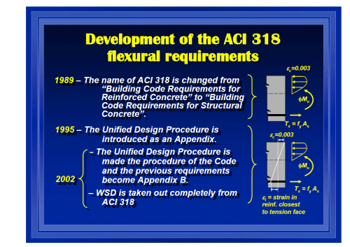

Working stress was allowed by ACI long after 1963 as part of the Appendix. If memory serves it was still in the code in 1989.
That is possible, JLNJ. My memory is certainly fallible, but I believe ACI-63 was the last American code I had which permitted WSD. As I recall, there was considerable resistance among Canadian engineers but, for me, once I was introduced to USD, there was no going back.
BA
BA & JLNJ - You are both right:
Most of my design work was with structural steel or wood, but on occasions requiring reinforced concrete, I used WSD to the bitter end (2002).

Thanks, SlideRuleEra. Nice biography of ACI 318.
