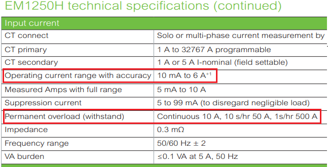

On the other side, for If CT ratio of 800/5 is used for 1200A continuosly, problem may be with metering circuit euipment. Normally meters are rated for 120% continuous rating.

On the point of meter or relay overload, the relays I'm most familiar with (SEL) typically have a 15A continuous current input rating and 20A at 55C. Instrument-rated revenue meters would generally be CL.20 meters (meaning 20A continuous) or Cl. 10 meters (10A continuous). I believe panel/indicating meters may be more like the 150% limit you reference, but I've seen a move to make them more inline with revenue meters lately.

Sample specification of one meter:
