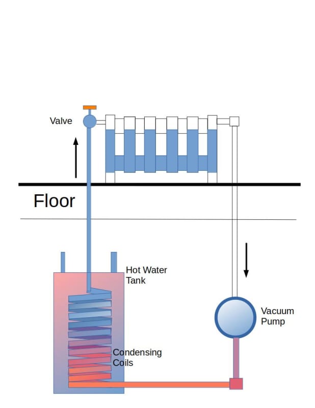

Essentially, you are talking about using water as a refrigerant (R718).
Also boiling the water in the basement would have the reverse effect of what you want. Heat would be absorbed and flow from the basement up into the house where the water would condense, releasing the heat.
A closed loop system could possibly work, but an ordinary vacuum pump would be damaged by the high humidity/water passing through it. Possibly some type of screw compressor designed for such a purpose.
A valve for throttling back (maintaining) the pressure would (probably) be needed in the return line, possibly an ordinary expansion valve for refrigeration or capillary tube, though high compression would likely not be required to condense water and should be avoided if possible, something of the sort would likely be required to maintain the vacuum in a closed system, otherwise, you'd just be sending bubbles through a tank of water or something.
The heat generated could be dumped into a water tank recovering some of the expense of running the vacuum/compressor.
Something like the following. No guarantee it could be built as a DIY project, or that it would work exactly as shown. and would probably require, or could develop dangerously high pressure in the return line, (relief valves required) but refrigeration systems using water as the refrigerant do exist. Mostly for industrial purposes. I don't know of any being marketed for residential use.

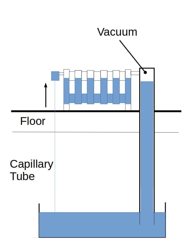

I'm wondering if the gravity vacuum idea could be used at less of a height if a larger column of water were used. Say a 4" or 6" PVC pipe, instead of the thin tubing. Water could be returned via a pump with a pressure tank and thin capillary tube, with just enough flow to replace whatever water boils off.
I don't think the vacuum created by the larger column of water going down would serve to draw a fine capillary tube filled with water back up? That would be like, not only perpetual motion but free air conditioning to boot. Though I'm having some difficulty figuring out exactly why that would not work.
It seems to be almost a certainty that a large column of water pulling a vacuum could lift the water in a thin capillary tube.
What's wrong with this picture?
Apparently, the diameter of the tube(s) makes no difference as far as the height necessary to create the vacuum (Pascal's Principle).
A capillary tube, likewise would (probably) not lift the water higher than the column on the other side, for the same reasons, though a true capillary tube does exhibit some odd properties, I wouldn't count on it.

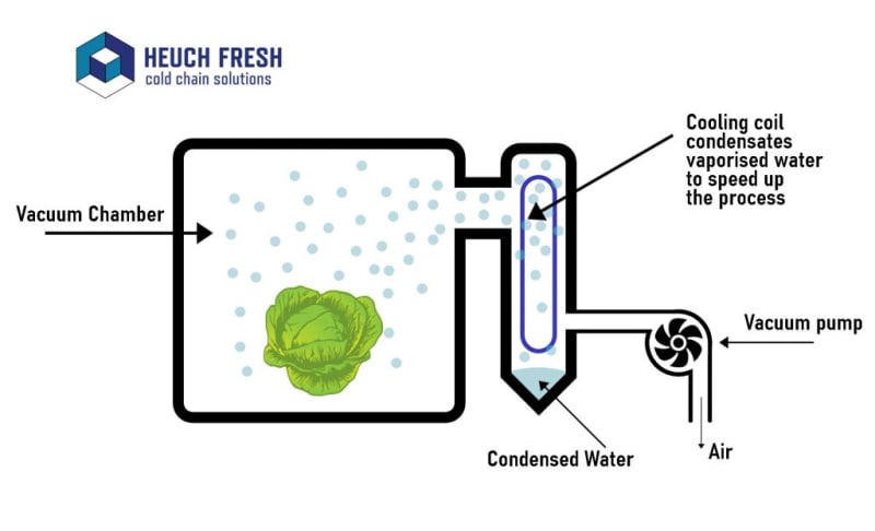

An interesting method used in vacuum cooling for food processing is to use a condenser, reducing vapor flow and drying the air before it reaches the vacuum pump.
The vacuum chilling process used is apparently several times more efficient than conventional forced air chilling.
This is however a batch process vacuum evaporating the moisture from the product itself. Perhaps it could be adapted to space cooling in one way or another.

@Tom Booth, you last picture seems a lot like a general principle for freeze drying. Although often when considering a powder or agglomerate you use a spray nozzle and/or fluidizing nad maybe low pressure to increase evaporaion/ lower temperature by evaporation.
