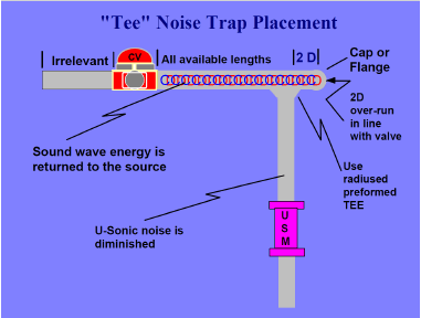

4) A noise "trap" (see attached image clip). I came across this in some literature from an ultrasonic meter supplier to mitigate noise upstream of the meter. I was pondering putting in a straight run of pipe with a dead-end, and then install a "T" takeoff which would go to the gas supply. I would likely acoustically insulate the straight run of pipe around the "trap"

Yes we are using a v-ball flow control valve. Please disregard the color image as it is just to show an example of the noise trap concept... The sketch best reflects the actual installation.
