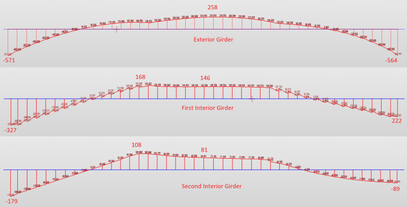

I actually have a FEA model for a 136ft long pretensioned girder bridge on a 29 degree skew that I can show you how the railing load distributes. Mind you, the girders are integral with the abutments so it may be slightly stiffer than yours...
Railing weighs 700 lbs/ft so total weight across the bridge would be 95.2 kips per railing line. Exterior Girder end reactions are 68 kips which is 71%.
Thank you both for your replies. I will be designing the interior and exterior girders separately so I planned on conservatively place 100% of the load on the exterior girder (since there is only a 1.5' overhang) and 50% of the load onto the first interior girder which I now know will have to be confirmed through analysis (most likely by a TCB analysis). Thanks again for both of your replies!
The TCB distribution would give you a slight uplift at the first interior girder. I believe the most conservative reasonable loading case for the 1st interior girder is the uniformly distributed load. For some configurations, slightly exceeding loading of uniform distribution at the 2nd interior girder with a TCB, is possible, but unlikely with a short cantilever.
TCB would give you a slightly higher load at the exterior girder (more than 100%), but with the short cantilever, it would be a minor difference.
