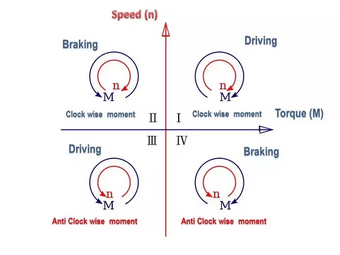

Is the main advantage of a 4 Quadrant drive only the capability to regenerate ?

You will need a 4 Quadrant drive otherwise you can't wind and rewind and break in both directions.
/A
Albert Einstein
Redsnake presents the essence of the reason you need a 4 quadrant drive. I am going to be a bit more wordy.
For hoisting the main torque is up when you are hoisting or lowering. Except for a short period when accelerating downward.
You could use a mechanical or eddy current brake external to the drive for dealing with the overhauling load, but except for small package hoists and a few unusual cases, it is less costly to use a 4 quadrant drive, and use the drive to either send the regenerated energy to a breaking resistor, or regenerate back to line.
