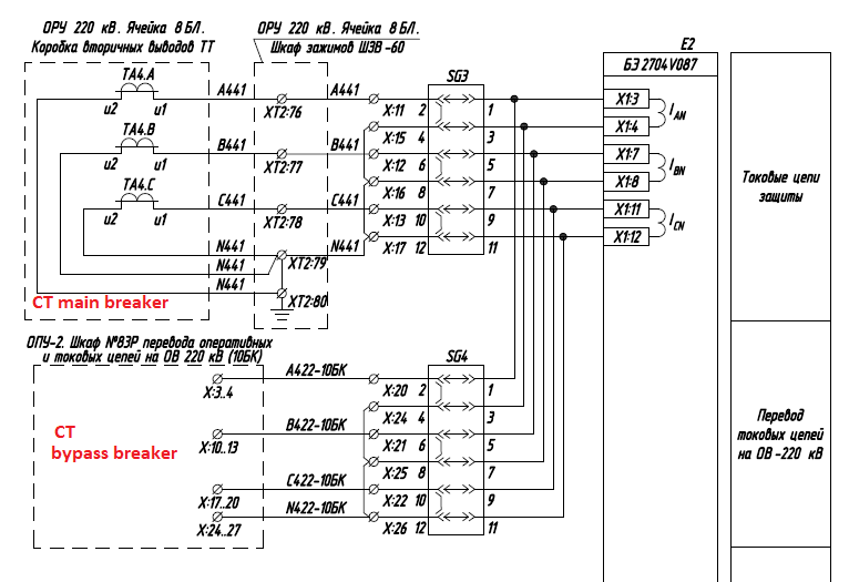

For example, we have a bypass breaker with the possibility to transfer any of HV lines through this breaker. When we take a main breaker of HV line in maintenance, we transfer HV line to bypass breaker and leave this HV line in service. All relay protection IEDs of this HV line change to trip bypass breaker by secondary switches.
So if we had combined BU and protection in one relay, we wouldn't able to leave the HV line in service.

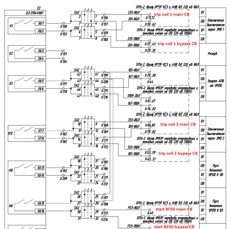

Protection relays can trip two breakers (main and bypass), it depends on position of secondary switches, but each breaker has its own bay control unit.
Bypass bay has only one IED, which implements only control functions, not protection. But protection IED of each feeder can switch to trip bypass breaker instead of main.

Yes, but we have one bypass breaker and 15 main breakers for each HV line. Each HV line can be transferred to the bypass breaker.

The reason is that you can take each main breaker in maintenance and leave primary equipment in service. Or when a control IED of a main breaker is brake down, downtime of primary equipment is a minimum.

In this case, we have to mount secondary conductors from a bypass breaker to all protection devices of HV lines. Circuits of coil control, disconnectors control, SF6 control, etc. It demands additional cost.
And I have a question, for what purpose? It's the easiest to install one bay control device to a bypass breaker and mount a couple of conductors from a bypass breaker to protection devices of HV lines (trip coil 1, trip coil 2, 50BF start).

I think it would not be that much more difficult to run an extra CT circuit and a sync circuit through each rack. I can't picture needing to run the discos, that can stay on the coupler's relay.
Any schematics?
It's local schematics, I added eng comment. It's a schematic of a main protection of HV line 220 kV.
CT circuits:
Trip circuits:
And these all connections with a bypass control unit.
Thanks. But being honest an SEL-411L/421 would be much the same making things simpler over all.
