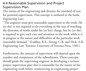

Ontario Canada guidance document image below. In my opinion you do not need registered engineers out at all times, if a technician or EIT screws up the company is just as liable if the supervising engineer doesn't catch the error before it goes out the door.
