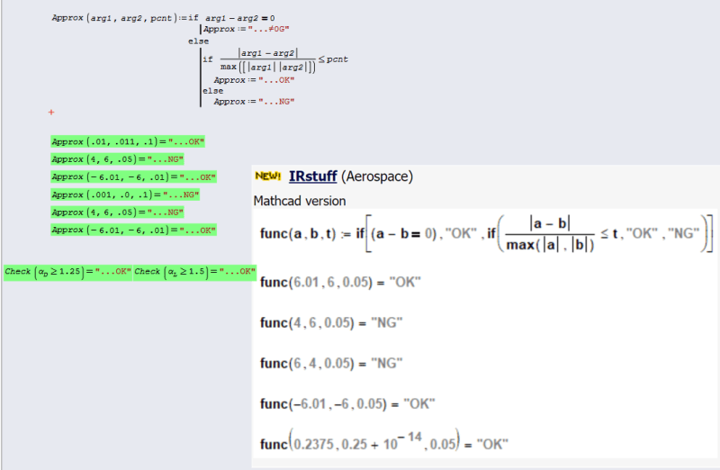

Does anyone have a bit of code for a function to confirm that two numbers are approximately equal to each other (using a stipulated difference say 5%?) I can do it if both the numbers are +ve or both are -ve, but it fails at values near 0, where one is +ve and one is -ve. Any help appreciated.
An Excel formula that works is:
=IF(A1-A2=0,1,ABS(A1-A2)/MAX(ABS(A1),ABS(A2))<Tol)
where Tol is a named range with the tolerance.
It should be pretty easy to convert that to SMath.

Thanks, Doug... will take a look at it.

...not called from other routines, but as a notification that the two answers are 'correct' or comparable.
Thanks, IRS... just what I wanted... I just found out that you can Windows paste directly into SMath...

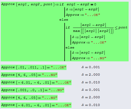

Improved... I had modified the original in case the second arg was a zero... Fixt...

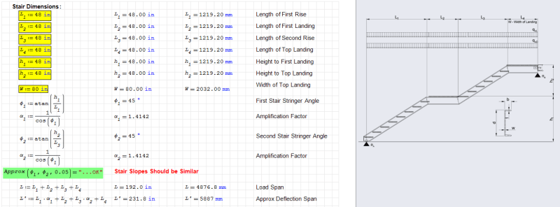

and in the program... the dimensions are all the same because I just 'cut and pasted' the variables and changed the name.
