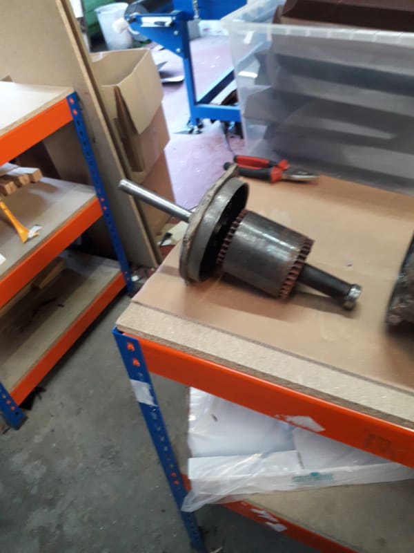

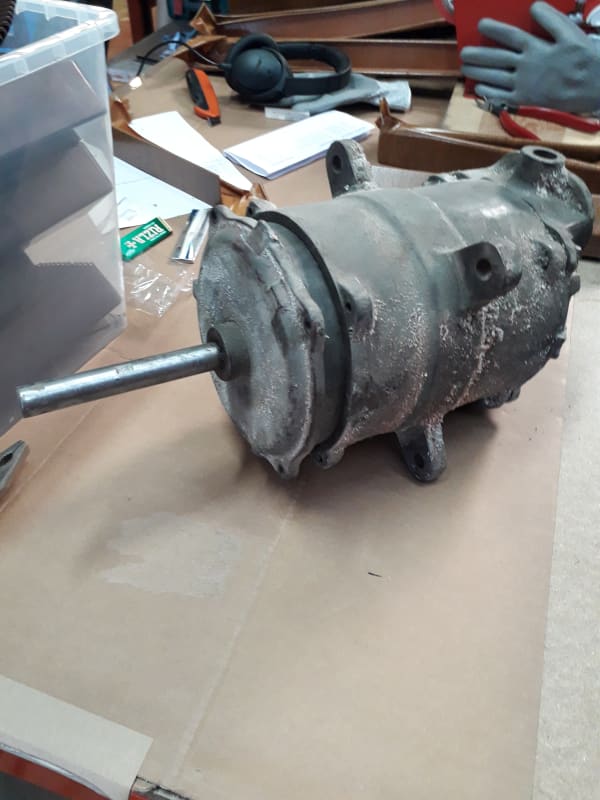

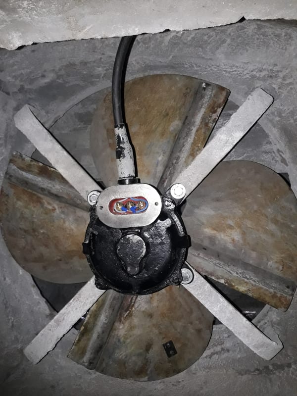

I have an old motor that has been rewound incorrectly, I have no information on the motor does anyone recognise the type of motor it could be from the pictures, I have been told it may possibly be an old mod motor off of a ship
The lengthy end bracket register fit somewhat suggests the motor was possibly intended for use in a hazardous location.
"But", the hefty register fit combined with the robust opposite drive end shaft... could also imply a large item was mounted to the motor's output shaft. (A big fan blade perhaps.)
It'd be interesting to see a view of the stator winding.
John
Going by the long shaft and the middle of the frame mounting, I would say a stirrer (vertical mount) or a fan on a horizontal mount. Probably 4 poles (1500/1800 RPM) to 6 poles (1000/1200 RPM) at 50/60 Hz. Going by the long shoulder/rabbet and sturdy construction, probably Ex class motor. Guessing around 5 to 7.5 HP.
What is your speed requirement? A good rewinding shop can do a stator winding redesign from scratch.

Thank you for the info, it is used as an extractor motor, not sure if the blade attached is original
It was rewound and bearings replaced by one firm and since then when the blade is attached it overheats, it was perfectly fine for 40 years but there only answer was the blade is probably too heavy. A second firm have tried fixing it but said after the repair that they only copy wind so if the windings are not right there is nothing they can do

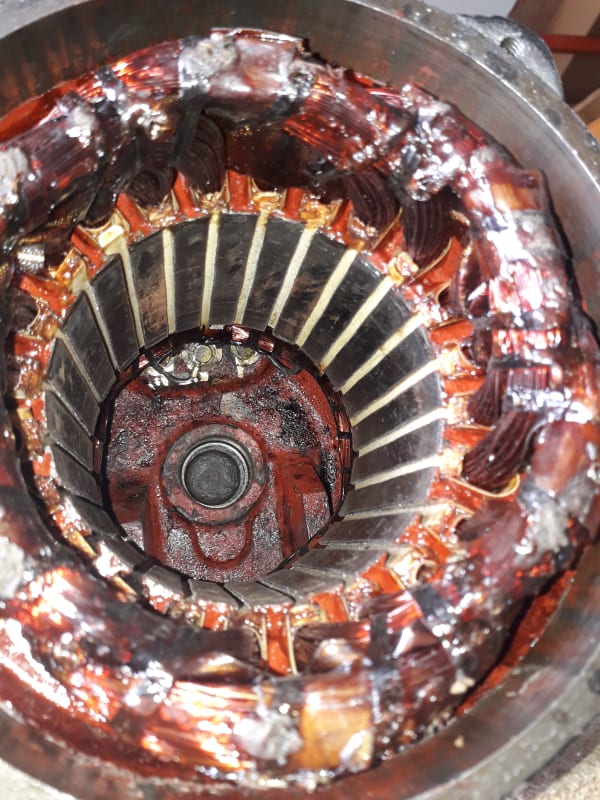

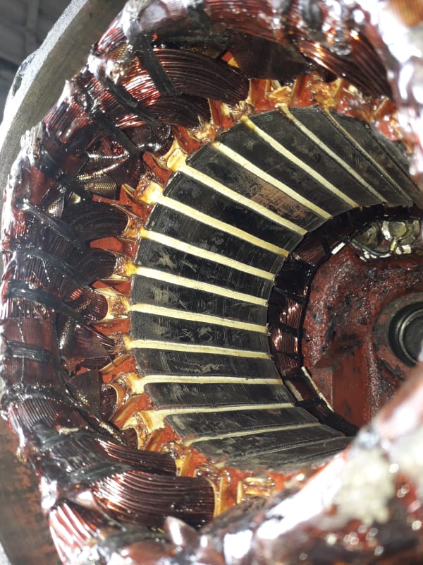

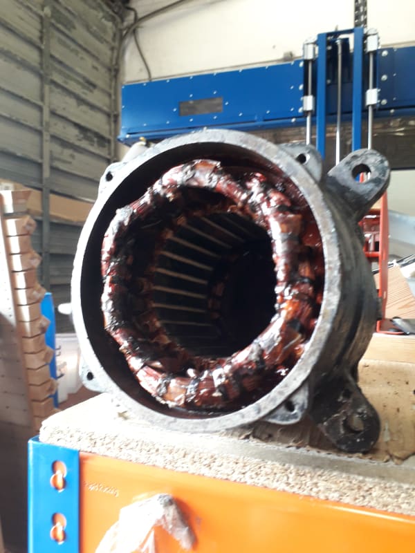

Here are some pictures of the stator windings from the taken front of the motor
I dont know what current it draws, the motor is too hot to touch and has a burnt winding smell after 30 minutes of running
Thanks for pics. It is clearer now.
It's a 24 slots, 4 pole, 1500/1800 RPM, 50/60 Hz stator winding. Possible reasons for overheating a) new blade is heavier than the old one or b) winding design is wrong (too many turns resulting in less ampacity). The workmanship of winding is not great either but that's not the reason for overheating.
Muthu
The fan blade has been used on the motor since 1978 running 8 hours a day and I have had it balanced also so doubtful that's the issue. I was hoping the first firm may have used a sub standard grade of bearings but it seems like the most likely answer is the windings are incorrect. I have been trying to get it repaired as where it is installed it will be alot of work to change the mountings and I haven't seen any other motors that are mounted the same way
I was going by your 'only answer was the blade is probably too heavy' which gave the impression the blade was changed. If the blade was original, then the winding design is wrong and I suggest rewinding it with a better repair shop since I doubt you can source an identical motor with this type of construction.

It runs ok without the fan doesn't overheat, it's only with the blade attached that it struggles seems like it's trying to draw too much power and spinning too fast, attached is a sound clip of the noise it makes motor is running at the start, power is cut 8 seconds in and restarted 13 seconds in. Before the first repair it ran pretty much silently after reaching full speed

It kind of sounds like a bearing noise ramps down in amplitude after the motor is shut off indicating a mechanical issue
in addition to the incorrect stator winding. If it were an electrical noise, it would disappear immediately upon cutting power.
It also sounded to me as if the motor took longer than necessary to come up to speed for the size it is.
Almost as if it was trying to start on a lower voltage. Others may chime in on what they hear and offer their interpretation of the noise.

With 24 slots, it is unlikely the original winding was 6 pole, 1000/1200 RPM. So, the fan is not spinning faster than the original 4 pole, 1500/1800 RPM from before. It's overheating due to excess turns and poor ampacity.
As John says, EASA is a very good source for locating good motor doctors in your area.
Muthu
Winding Gurus: Could it be as simple as a star connection that should have been a delta connection?
Bill
Ohm's law
Not just a good idea;
It's the LAW!
Good point, Bill. That could explain the heating (too many turns for a star connection and more current density at full load).
Pity only 3 leads are brought instead of 6, which would allow changing the connection. Now, the delta connection has to be done at the winding.

I was unable to open the sound file, but from the descriptions of the sound, could that be consistent with a star connection that should have been delta?
A question to the shop on the possibility of a wye/delta mistake may be productive.
There is nothing wrong with the winding, just an easily made connection issue.
