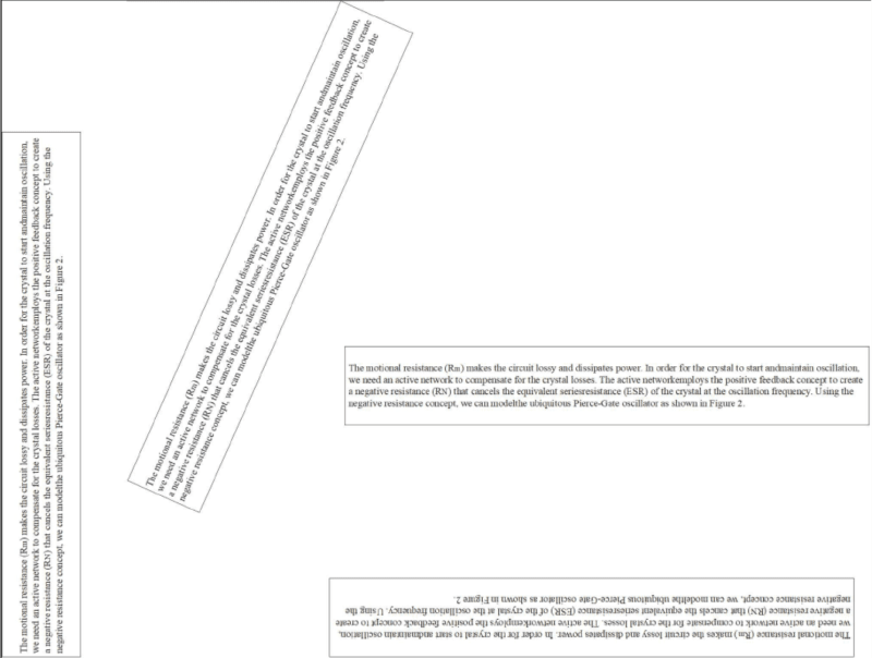

Acrobat's OCR works pretty well for rectilinear text and boundaries and correctly interprets grids around text as being part of a table; that said, it's not really designed to do OCR on arbitrarily oriented text. In the example below, it was only able to properly recognize text in the upright orientation; upside-down text was OCR'd, but it assumed the text was right side up and resulted in gibberish. So, it basically detected a series of "objects" oriented and arranged as text, but it didn't have the means to determine that the text was upside down. The vertical text is apparently ignored because it already had what it thought was text in the correct orientation. Any one of the text boxes alone would have been OCR'd correctly, because it would find the orientation that results in a good OCR.
