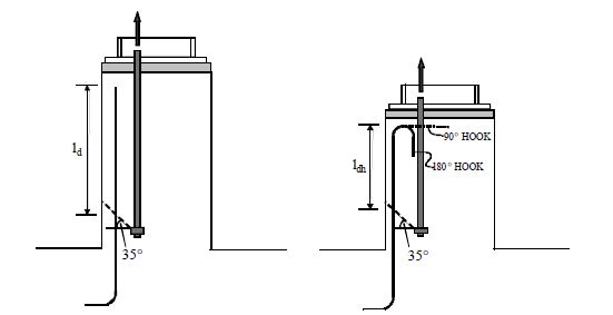

You are expected to provide pedestal reinf. not only to provide bending resistance but also to transfer the load to the ftg..ACI 318 specify the pedestal reinf. at 16.3.4.1 at least 0.005Ag, where Ag is the gross area of the supported member.
The followinf excerpt from ASCE ANCHORAGE DESIGN FOR PETROCHEMICAL FACILITIES shows the concept,
@hadeer salah
you must have another calculation check, anchor bolt check in particular, and see the failure whether in shear or tension,
but yes you can use the reinforcement of pedestal as reinforcement for anchor bolt.
