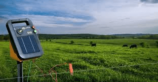

Here's another option. No batteries needed.
Perimeter barrier system:
No need for expensive and time consuming burial.
Easily moved.
Easy recall of grass cutters after use.
Edit: I forgot to mention the free fertilizer as an added benefit.
