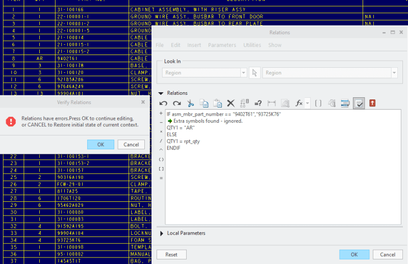

Thanks for your reply...
Here's what happens when I try to add the other part numbers..
I followed what's in a Pro/E User's guide...
And yes..these parts are "bulk" items, but they are actual models of bulk items that I modeled so that it shows up in my drawing. The only time I use "bulk" item is glues, adhesives, etc...
I've also tried to add each part separately in the editor.
IF asm_mbr_part_number == "9402T61"
IF asm_mbr_part_number == "8117A25"
IF asm_mbr_part_number == "93725K76"
I get the same error message...
RE: Bulk Item Quantity Repeat Region Relation - Creo 5.0
That's why I said use ELSE IF.
You cannot use a comma separated list and cannot use sequential IF statements without matching ENDIF for each one in the relations.
The section showing the comma separation is for "By Rule" in the FILTER section, not in the RELATION section.
The Relations are a separate programming language; the filters are directives. It's a subtle difference that PTC might have done better to improve - the writer of that book did not do a good job.

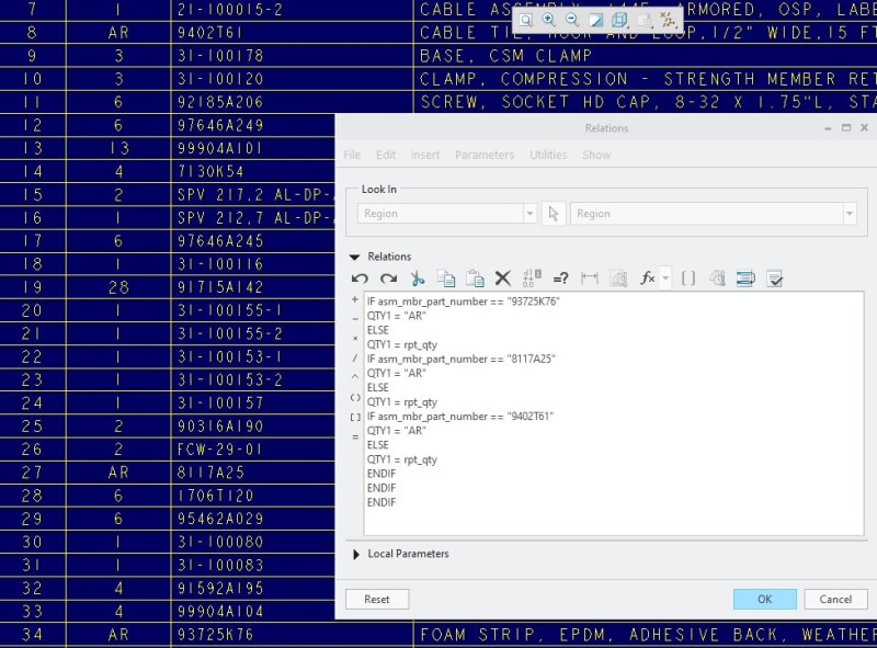

Finally, figured it out...
I nested all the IF statements together, and it finally worked!
I did put the ENDIF statement after each "QTY = rpt_qty" statement, but it didn't work. Then I placed the three ENDIF statements at the end, & it worked!
Thank you!
