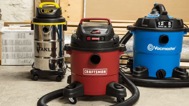

Or just buy a wet and dry vacuum like this.
