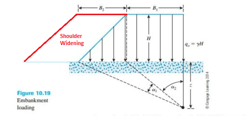

Hi All,
I've just commenced the geotechnical investigations for a highway widening which seeks to add an additional carriageway to our existing highway.
There are some substantial fills (10 - 20m high) along the route, mostly coinciding with drainage structures (large culverts) beneath, and I need to calculate the anticipated settlements beneath the proposed fill widening. Both the existing and the proposed widening are sloped at 1:2 (V:H).
I am unsure how to calculate the settlements with a fill shoulder widening- I'm currently trying to configure the profile on Settle3D (Rocscience) but I'm struggling. I would also like to know how to calculate the earth pressures by hand. There are a number of cases where differential settlement between the existing culverts and the proposed culvert extensions will be difficult to design for, so I want to be as accurate as possible.
Any guidance or references would be greatly appreciated.
Best,
Mike

Mike,
I agree that a 2D/3D FEM would be the most accurate solution but unfortunately you done have that luxury. But SETTLE 3D should also work?

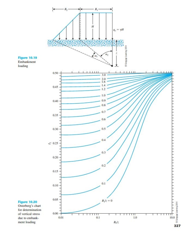

Das - Principals of Geotechnical Engineering, has a section on embankment loading. The only difference between settlement calculations beneath an embankment is that you will have a variable stress beneath the sloped portion.
You should be able to use the below to assess the magnitude of stress, then settlement across the across the pipe?
EireChch,
Thank you for the detailed and informative response. See my sketch below - I'm comfortable calculating settlements beneath a new fill embankment, but in my case we are doing a widening of variable width on the shoulder of an old fill embankment. In some cases the widening will be a thin sliver, but in other cases it will be very wide.
Significantly different to your sketch though, is the fact that my fill embankments- both the old embankment shown by your blue line and the new embankment shown by my red lines- are sloped at 1:2 (V:H), so because they're much flatter, there are many cases where the final widened road shoulder does not extend to beyond the original fill embankment toe point.
The settlements beneath an extremely narrow shoulder widening would be effectively zero (for a nominal sliver of new fill benched into existing) but then obviously, as the shoulder widening increases, the amount of stress on the natural ground at the toe of the widening gradually increases, until effectively we are creating a new embankment. In this last case, I simply model a full new embankment and calculate settlement from that, but in the intermediate stages of widening (say widening by only 3m, 5m or 10m) I don't know what pressure to apply to the in-situ ground beneath the widened embankment.
I suppose I should explain that the variable extent of the widening is because some of the widening was planned for- the fills were therefore constructed fairly wide during the original highway project, more than 20 years ago, but there was not enough material to accommodate the width of carriageway that we are now looking at.
