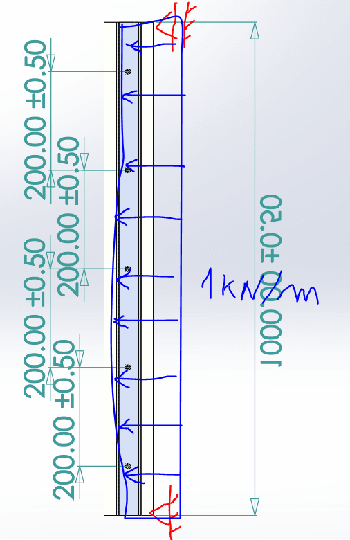

I have an aluminum U chanel that where a cladding will be fixed. This cladding will transmit forces according to the scheme below.
This forces will tranlate on a bending moment according to the yy axis on the aluminum chanel and steel bar.
Can someone help me on how to properly design the spacing and specifications of the bolt for a specific Bending moment on yy?
How can I calculate the shear forces?

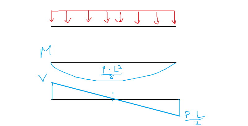

Perhaps I was not clear at first. Imagine this as a simply supported beam subject to loads on the yy axis. The maximum moment would be (P*L^2)/8.
This bending moment would develop some shear forces on the bolts. This is the force i'm interested in designing.

I was thinking on a hypotetichal case. But to have some values heres an example:
Imagine a 1 m simply supported beam, subjected to F=1kN/m. The spacing between the 5 bolts is 0.2m.
@drawoh , thank you for your suggestion. This is just an theoretical case, as i'm planing on doing a series of solutions like this.

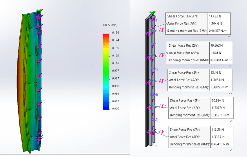

This is the expected forces I got from my FE model, but I would like to have this done trough hand formulae.

Right well for starters it’s not a simply support beam because the bolts actually make it a statically indeterminate beam, I need sometime to sketch an example of how I would solve this assuming that the channel is rigid. I will post later.

Just looking again at your last post, Am I right saying the steel reinforcing is actually the simply supported beam but it’s loaded via the aluminium channel section through the bolts?
Hi @desertfox
Yes, you are right. Thank you again for your time and promptitude.
Does anyone know how to properly calculate the shear force across the lenght of the bar? This would help desiging the bolts.
Normally, I would assume that the diagram, but this would imply that the shear force on the middle bolt would be 0, that is not true according to my FE model.

You are doing the first stage of double integration method. Your shear forces go across the bar, not along it.
You could model your distributed load, and treat each screw as a solid reaction point. The bending of your bar might be interesting.
