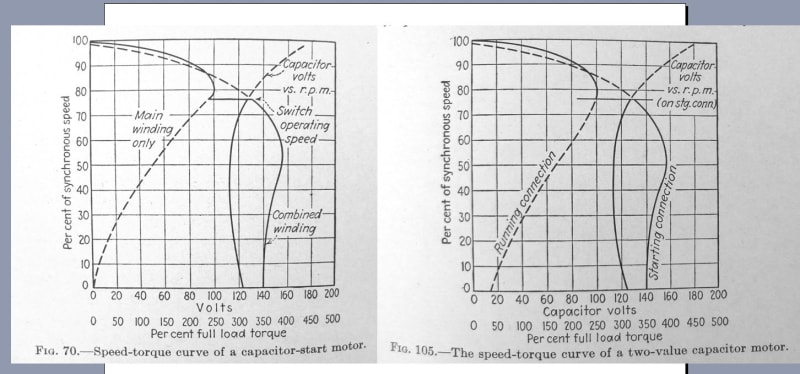

Here are two more graphs lifted from Cyril G. Veinott's 1939 book. I have his 1948 second edition also, but the graphs are the same.
In his text, he notes that the capacitor-start motor has substantially the same torques as the two value motor, and that they are practically identical.

Thanks guys, both posts have something new for me.
I had thought there would be some archetypal differences between the two, but the two graphs and Veinott's description would say not. Yet the fact that the 2 types, by design, reach rated power at different revs (Cap start's at 95% of synchronous and Cap Start/Cap run's at 90-92%) says the curves should be different.
Got to accept that the differences may not be significant, esp if power delivery from 2 similar motors form different manfr's will probably be different.
