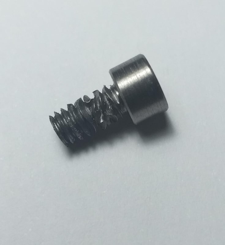

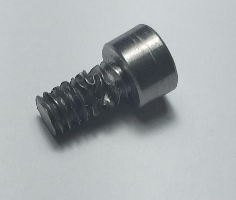

I have a 8-33 Tantalum bolt which we manufactured according to ANSI Standard.
When tightening the bolt we got a strage and unfamiliar (at least to me) failure of the bolt's thread (I attached photos).
I thought that when designing according to the standard the shank should fail before the threads.
In addition, even more strange is the thread didn't really tear off the shank but it looke like it plastically deformed.
What can you say about it :-) ?
I can say - how much engagement was there?
The screw failed in torsion and wrinkled the thread in the area of failure. Presummably the threads not engaged in mating threads.

To me it looks like the bolt yielded in torsion while tightening and the yielded again during loosening to give that back and forth wrinkle. It seem like the threads seized or the bolt bottomed out in the hole.
Did you try an anti-seize treatment? What are the tolerances of the threads?
Pure tantalum has a 50% elongation - per one bolt source. And still has a non-zero yield strength. That's an uncommon material specification, so it's not a surprise about the uncommon failure.
I agree that the screw must have either bottomed out or snagged something in the hole as it isn't a tensile failure. I've seen those in stainless steel and the main ductile change was a large increase in thread pitch.

I agree that this appears to be torsional yielding of the bolt where the threads were not engaged with other threads. The waviness is due to compression buckling of the thread tips.
As tension is developed by tightening the bolt elongates and the thread pitch increases with it, much like a Slinky toy the pitch increases with tension. If the bolt has significant elongation ability the un-engaged threads in tension will stretch. In this case the pitch appears unaffected, just angular displacement, so the waviness wasn't a result of tension.
The material is soft, so there would be no noise to its galling.
How did you take it out might direct us to answer correctly. Did you find any failure on the inner thread? What exact materials and heat treatment were used on both sides? Note that first four threads did not fail like the others.

You say you unscrewed without any excessive force. In that case, when you screwed it first time the first four threads engaged without any problem and fifth and sixth were damaged as given on the photos. This seem to be unusual isn't it?
In that case, if possible, I would check the threads on the bolts, there might be a manufactural mistake between pitches on the same bolt.
Or there might be something on the fift and or sixth threads during the tightening that caused this kind of failure. Is this happening on all the threaded connections? If not this might be the cause. If it is happening I would question the pitches of the threads on the same bolt and/or between threads on the oppsite connected members.
Is this the first time you have used this bolt/material in this application?
Could be worthwhile repeating the assembly / bolting while carefully observing what is taking place, ie is the bolt free in the tapped hole, any signs of binding, what is the surface finish on the female thread -rough /smooth any sign of galling, try lightly torquing the bolt, remove and check thread surfaces for damage, was the failed bolt over torqued?
