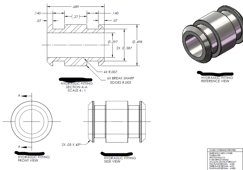

So I have a Sofrance (Safran Group) CMM that calls out connector type NSA 8676 #6 for connection to port NSA 8677 #6. I can find the NSA 8676 bobbins for sale, but I want to know more about this fitting and can find nothing in the way of specifications. Can anyone provide a copy of the spec or point me to the standards body that created it so I can get it from them if it's not freely available? Are these Airbus specs?

I did further searches and came up with "Norme Sud Aviation". So they may have been Sud Aviation standards. The fitting is an O-ring bobbin that mates a .500 hole to a .500 hole. The part I have has two of them and I was wondering if the two together were one fitting and the distance between them was a standard or (more likely) if each fitting was independent and the distance was as needed for the part.

And Sud Aviation is defunct so the lack of info is understandable. I think the fittings can be purchased, but I RE'd the ones that came with the part incase the next part didn't include them. Not exactly like what it came with, the original was slightly asymmetric with one end being ~.007 smaller, but I figured making them symmetric was a better idea.

It's on the Airbus site under Standard Materials, it's an aerospatiale standard for a drum. The hydraulic fitting Kirby shared is somewhat similar but not identical.

In the Airbus site, I went to a tile called Associated data, then airnavX, search on NSA8687 in the large "search on content" field and it retrieves different NSA8687 hits, they pretty much all deliver a pdf symbol that pulls up the spec, or you can scroll down to SM (for Standards Manual) specification NSA8687.

The site you want is w3.airbus.com to which my company has access permissions as it is a requirement for access. Unfortunately those access permissions contain an NDA that prevents me from just handing you the Standards Manual. I do not know if the Standards Manual is available through any other means as when we need it we use our w3.airbus.com permissions.

Thank you. I expected as much and wouldn't want anyone to violate a NDA. A decade ago someone asked for the FCBS for the DC-10 and I had a copy and provided it, and Boeing slapped my wrist for it. We should take the old mil-specs and create open source specs based on them. I expect all the standards orgs would have an eye twitching conniption fit. I feel my design based on a physical article is close enough to satisfy my needs. I can live without the completeness of having the original standard it was based on, though it will feel like an empty place in my soul.
