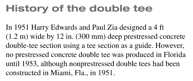

Here is a link to a PCI Paper entitled: "The legacy and future of an American icon: The precast, prestressed concrete double tee" by Nasser, Madros et al., dated 2015: Link
There is a brief historical discussion of the 4DT12:
