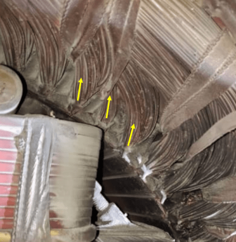

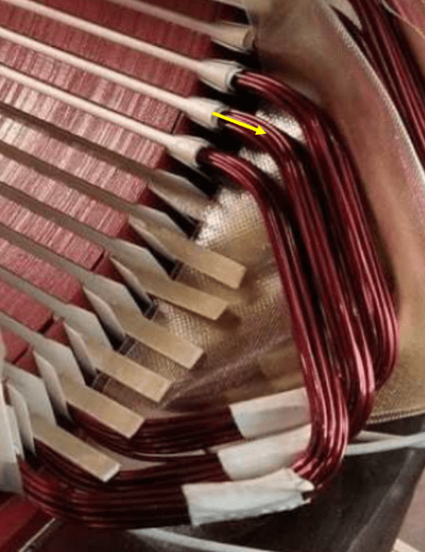

Our alternator 950 kW 400 Vac stator has failed. The protection relay Micom tripped by Restricted Earth Fault.
Up to now we can see the damaged part of the stator winding as attached picture.
There was no disturbance on the utility network or internal fault on any motor. We have restarted the plant with the boiler operating now.
There are 4 cables per phase coming from the stator winding which is connected to the output L1,L2,L3
One of these cables on each phase is short with the earth. The environment is full of dust particles. The dust particles are residue of coal ash after it is burned in the boiler. There were dust inside the stator. The alternator is air cooled with no water refrigerant on top.
What might be possible cause of the stator winding failure?
Plz see attached picture

Based on the one photograph, the failure appears to have affected 3,
possibly 4 slots confined to one coil group from the same phase.
There could be further slot damage visible in the stator bore once the rotor is removed.
Without a few more photos of potentially affected areas, it's a tough call to make a good guess.
It looks like a cascading failure spanning more than one slot. The cause of this failure is possibly
hidden from view until the rotor is removed.

Going by your photos, I would say the dust contamination is not that severe. The winding failed due to a)aging which is normal or b)poor winding quality if it's a machine less than 15 years old.

The winding has been cleaned. That is why it may not look that dirty. we are waiting for insurance instruction to proceed further.

My first guess: the reason is contamination + aging.
But, there is also a very good predisposition for premature failure.
It is the shape of an old coils.
If the coil comes out of the slot at such an angle, there is a good chance to damage or weaken the slot insulation already during coil-inserting .
A diamond shaped coils should be made instead (see picture below).
If the dimensions of such a winding are chosen correctly, the width and height of the end winding will be less than before.

The original winding looks like a multi-pitch winding while yours shows single pitch coils. I doubt such ground clearances, while preferred, can be achieved in multi-pitch coils.
Muthu
It can be better even if it is a concentric winding.
Such a size and shape of coils plus hitting with a mallet is a recipe for a bad job.
After all, the winding does not have to be concentric.
If diamond-shaped coils are used, a mallet is almost not needed.
Winding Design and Analysis
@zlatkodo
Agreed. In our shop, except for 2 pole machines, we convert all multi-pitch windings to single pitch windings and we hardly ever use any mallets.

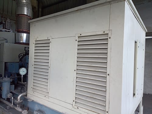

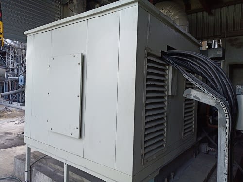

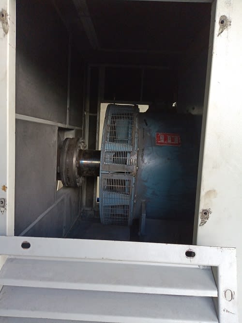

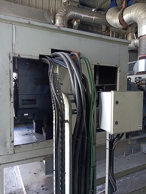

Hi
The stator has been rewinded and alternator put into service. After about 2 weeks in service, we see there are some dust inside the alternator.
The dust is from coal ash. There is a box around the alternator with 2 filters as shown in attached picture.
We want to improve the system. There are holes at the cables entry and the drive end shaft. Can we remove the box completely and put a filter directly on the opening at the alternator non drive end where it sucks in air? The air passes over the winding and comes out at the drive end opening. Is there another way to improve the cooling?
We cannot run the alternator at max. load due to temperature rise now.
The supplier has confirmed that we cannot add an air cooler or water cooler on top of the alternator.

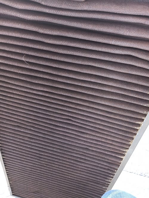

They look like like louvers to me than filters. The enclosure will definitely reduce the airflow needed to cool the machine. With that type of basically open enclosure with no filters to prevent dust, you might as well remove it for better cooling.
For open type machines, the dust itself is not a problem, it's the accumulation of dust over windings that is a problem. Any filters you add to the air intake will reduce the air flow and hence the cooling of the machine.
Properly sealed air to air or air to water machine heat exchanger is the only way to prevent dust entry into the machine.
Muthu
Is it not reasonable to supply the enclosure with a fan ducted from a clean source or filter?
There is a filter behind the louvre as attached.
