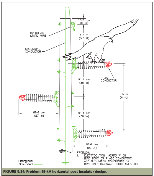

Hello Everyone......... We are designing the 35kV power-line in the area of high bird activity and one of the suggestions presented from the stakeholders was to use bigger line-ground clearances on the structure which are mostly bird targets (like corner structures or structures with crossarms). One way to achieve this is by using higher voltage class insulators like 69kV, which would provide additional 300mm or so clearance.
My question is ......... would there be any concerns with using different line to ground clearances on different structures of same voltage level?

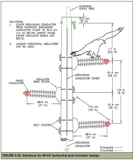

There is useful reference material available on the subject. I have attached Avian Power Line Interaction Committee (APLIC). 2006. Suggested Practices for Avian Protection on Power Lines: The State of the Art in 2006. Edison Electric Institute, APLIC, and the California Energy Commission. Washington, D.C and Sacramento, CA. (source of the above pictures)
I'm thinking if tree wire or covered wire could help in this application. Spacer cable has been designed and used up to 69kv.
No problem using different clearances. Sometimes utilities have long term plans upgrade the voltage on a section of line, and start by using higher rated equipment during routine maintenance. In my region it is common to see 69 kV lines where older poles have 69 kV insulators and all the newer poles have 115 kV insulators. It is also common to use higher BIL (i.e. longer) insulators on portions of lines in areas subject to insulator contamination from pollution or salt spray.
