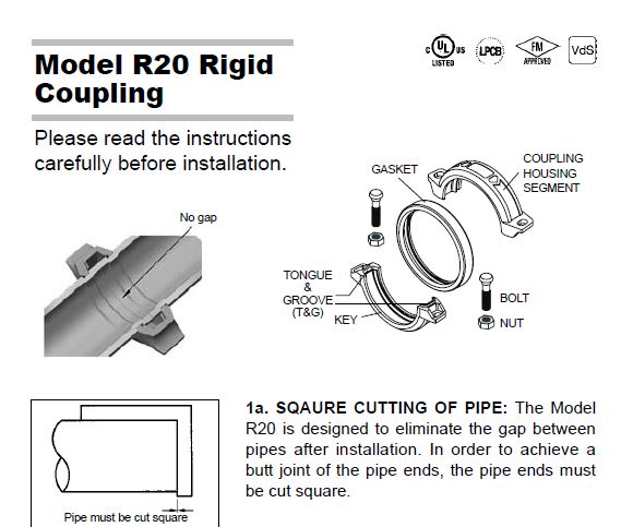

May 27, 2021 #1 Mohamed.Shehab Mechanical Joined Jan 22, 2020 Messages 7 Location AU Gents, do anyone knows what is the meaning of RGBE in this?
May 27, 2021 Thread starter #2 Mohamed.Shehab Mechanical Joined Jan 22, 2020 Messages 7 Location AU does it mean Roll Grooved Butt End? Upvote 0 Downvote
May 29, 2021 #3 HTURKAK Structural Joined Jul 22, 2017 Messages 3,361 I think also similar.. RGBE , Roll Grooved ( BUTT/ OR BEVELLED ?? ) END Better to ask to the pipe manufacturer.. Typically roll grooved ends are plain ends with square finish.. The coupling manufacturers ( typical VICTAULIC ) do not use this abbreviation. Excerpt from VIKING inst. handbook. https://www.vikinggroupinc.com/site...ts/Shurjoint Installation Handbook-2009_1.pdf Upvote 0 Downvote
