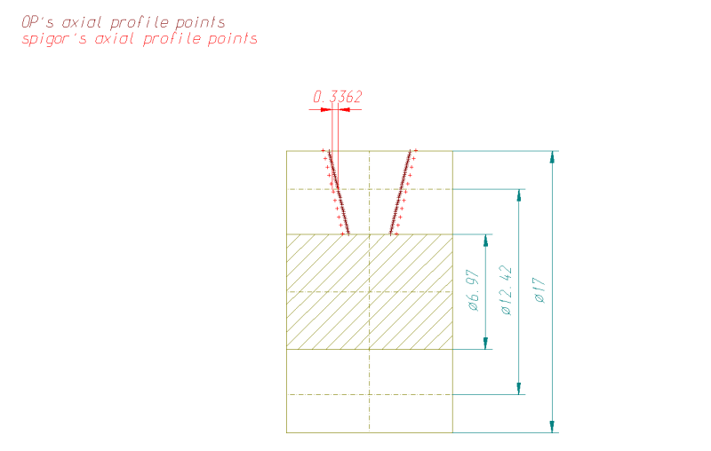

Are you able to use CAD to compare profiles? You didn't make any comment on the ZN, ZI and ZK profiles I calculated in the previous thread with some issues being repeated in this thread. There are online dxf viewers like or available.

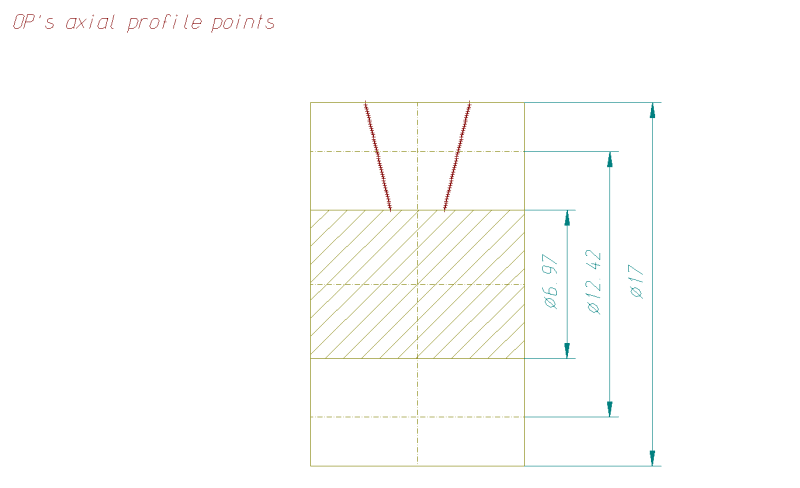

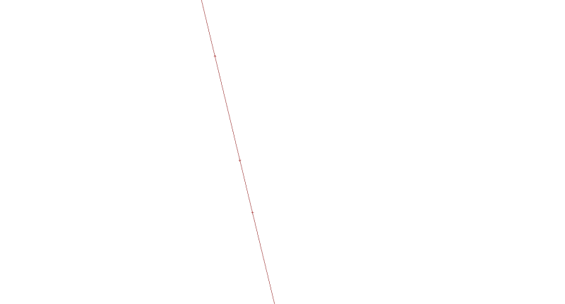

First I took your ZN_SingleLead_AxialPoints.Dat file and imported it into CAD to see the points on a sketch of the worm.
The tool is a flat reference profile, tilted 20.14° with 14.5° profile angle. Assuming both flanks are generated at once (duplex mode - it's an important assumption, having influence on the end geometry of the worm) because no other information is given, I calculate the tip width of the tool at ø6.97 (root diameter) in its normal plane from the wire measurement to be 2.8271 mm. BTW I calculate this assuming a ZI worm - for a good reason that should become obvious at the end, so there will be a little difference between the tooth thickness on the reference diameter between ZN and ZI, which can be seen in the dxf file I have attached in the previous thread.
The interaction with the tool can take place only on its edges (by definition of a ZN worm). I can now take any point on the tool's edge, calculate the angle φ it is displaced from the axial plane, rotate it by -φ around the X axis so it travels into the axial plane (Z=0), and translate it axially by φ/360*axial pitch. E.g. I take the point on the normal profile of the tool:

I import that into CAD:

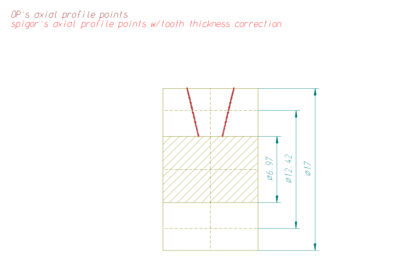

Looks like the wire measurement is wrong again, or we are not using the same definition of wire measurement. Mine is to take 3 wires, put the worm onto two on a measuring table, insert the third wire on the top and measure with a height gauge. I take a correction and get:
x; y; z
1.273618; 3.505342; 0
1.389958; 4.008747; 0
1.507509; 4.51217; 0
1.625905; 5.015606; 0
1.744916; 5.51905; 0
1.864388; 6.022501; 0
1.984213; 6.525958; 0
2.104316; 7.029418; 0
2.224642; 7.532882; 0
2.345147; 8.036348; 0
2.465802; 8.539817; 0

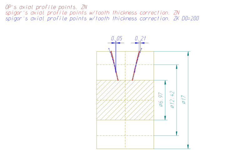

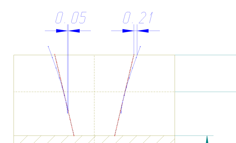

The OP's points match my points w/correction over the entire profile.
I suspect you use the points in the normal plane to shape your grinding wheel. As stated in the previous thread, that would not be correct because the wheel will grind outside the normal plane. With a 200 mm wheel it would look like this:
So, to grind a ZN worm with a disc shaped tool, you need corrections on the tool which will compensate for the differences between the ZN and the ZK geometry.
Last but not least - the tool tilt angle does not have to be equal to the lead angle on reference diameter (here 20.14°). Using a different angle and corresponding corrections may sometimes be beneficial end is used e.g. in grinding of helical gears.

OP said:
...what we're doing is trying to generate the profile mathematically.
Right on. I will now expand on the calculations to show their mathematical side a bit more.
I have the reference diameter 12.42 and axial pitch 14.311, so I need to calculate the lead angle on reference diameter exactly:
γ=atan(14.311/Π/12.42)=20.141722°
We have got a point on the tool's edge:
x; y; z
1.41355; 3.485; 0
That's because the tip width is 2.8271 mm, we are looking at first point on the tip, so it's x=2.8271/2=1.41355. The tool will reach down to the root diameter of 6.97, so it's y=6.97/2=3.485
I tilt it by the lead angle γ and get:
r=x=1.41355
x'=r*cos(γ)=1.41355*cos(20.141722°)=1.327103
y'=y=3.485 (we are rotating in the xz plane, y stays the same).
z'=-r*sin(20.141722°)=-0.48675
x; y; z
1.327103; 3.485; -0.48675
I calculate the angle φ this point is displaced from the axial plane:
φ=atan(z/y)=atan(-0.48675/3.485)=-7.95101°
Now rotate it and move to the axial plane:
r=SQRT(y^2+z^2)=SQRT(3.485^2+(-0.48675)^2))=3.518828
x=1.327103-14.311*(-7.95101)/360=1.643177
y=r=3.518828
z=0
x; y; z
1.643177; 3.518828; 0
I have calculated 11 points on the tool's edge like this, every 10% of worm's profile height. Since the da=17 and df=6.97, the next point is located on height calculated as follows:
17-6.97=10.03
10%*10.03/2=0.5015
6.97+0.5015=7.4715
y=7.4715/2=3.73575
The profile angle is 14.5°, so the x coordinate on the profile at height 0.5015 is:
x=1.41355+0.5015*tan(14.5°)=1.543247
x; y
1.543247; 3.9865
If I repeat the whole calculation procedure with above profile point I get:
x; y; z
1.750705; 4.021763; 0
This is a second point on the ZN profile as shown in the message dated 28 May 21 12:28 above.
Now you have a complete explanation with example points calculated on how to calculate axial profile of a ZN worm. The results of this calculation match those delivered by your software.
Is there anything else that is not clear in this thread?
Richard
