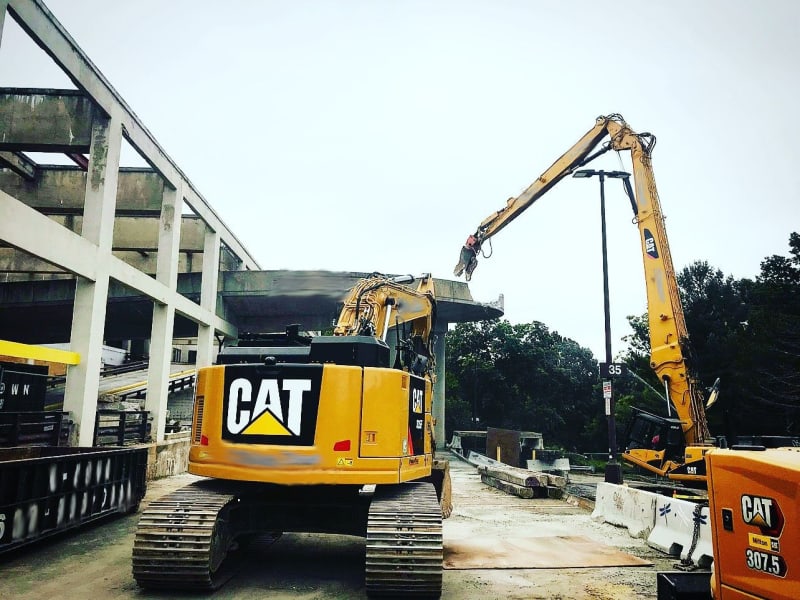

That's why when I'm dealing with post-tensioning stuff... I like low power chipping hammers...
So apparently it wasn't prestressed...
