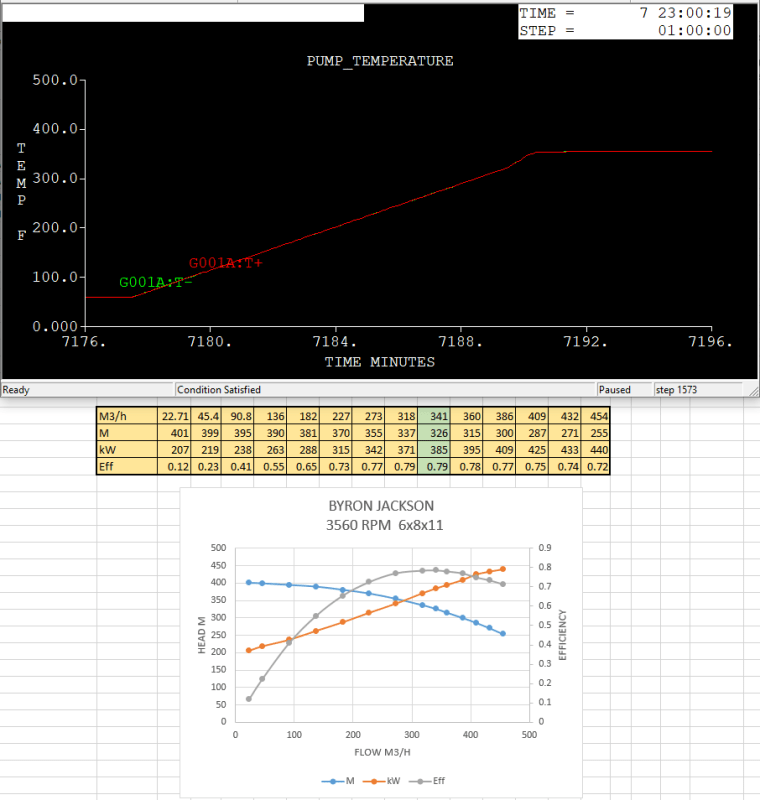

Nick, TugBoatEng is correct. He gave me an idea. I can do that. Let's just put it in the simulator. You post the pump Make & Model, the Q-H & either power-Q or Efficiency-Q curve and tell me the BEP speed, power and flow ratings. Also need to know what you're pumping and the driver type and control arrangements. Is it constant speed electric, VFD-electric, or internal combustion VSD, and it is on RPM, flow, or discharge pressure control. Then we'll find out how fast it heats up flowing to a tank/pipeline, or recirculating while at various speed, or various flow rate or discharge pressure settings. I forgot that I did the same analysis for those pumps I mentioned above.

I had a pump similar to yours laying around in the virtual pipeline warehouse.
Assuming you have a temporary tank, that you can flow 300m3/h to that and recycle 100m3/h to suction with only a 1C rise in temp.
100m3/h to suction and 300 to tank or pipeline will not raise temperature more than 1C
200m3 to suction, 200 to tank will get you +2C
250 to suction, 100 to tank will put you at +4C
275 to suction, 50 to tank +6C
300 to suction, 25 to tank +10C
More than 300 to suction will constantly raise temperature.
> Dead head, I'll give you 9 minutes to get to 250F (120C).
In 15 minutes you get a firewater deluge.

Yeah, I know. But it doesn't matter, as thermodynamically it amounts to the same thing; the heat has nowhere to go. Yes, that's what I told him in the first post. Just 20% "minimum flow" (forward flow) is more than enough to keep heat from building up. In the sim, you only get a couple of degrees build up at 100m3/h. You could do that 24/7. In fact you can easily recycle 50% BEP flow.
What I don't understand is what Nick thinks operating at minimum flow means. Min flow for me is the flow leaving the pump and recycle lines, going down the pipeline, to tank, etc.; the flow NOT being recycled. Does it seem to you that he thinks it is something else? Nick, the fluid spinning in the pump plus that being recycled back to suction is not minimum flow. Minimum flow in the case of a constant speed pump is recycling as much as possible while only allowing a minimum flow to leave the pump & recycle to go out to a pipeline or tank. Minimum flow in a VSD pump is the same, that going into a pipeline or tank, the difference being that you don't need a recycle to do it, you just turn the pump speed down lower to get that minimum flow. That is a big difference. The VSD is not wasting a lot of power at low flow. A constant speed is usually wasting a lot of power when on recycle, unless your recycle line is so big you can do it with no load/head. Could you please explain how you will make min flow?

He's only got 9min of doing that with a typical arrangement. I say typical, because if you recycled back at 400m3/h, the pump would not have any load, so you could go on for awhile doing that, but that's not the way most systems are configured. I doubt that a recycle line and valve are size for 400m3/h with bascially no pressure drop.
Usually you want to recycle while you load or unload near highest delivery head, so recycles are not sized for zero pressure drop, so the diameters and flow capacities are towards the 50-150m3/h, rather than 400 BEP flow. So, there is usually some significant power being expended when on recycle, just do to the recycle's pressure drop. So therefore it heats up. At full BEP recycle, maybe you aren't going to be making much heat, due to the low head. Could that be the plan?
