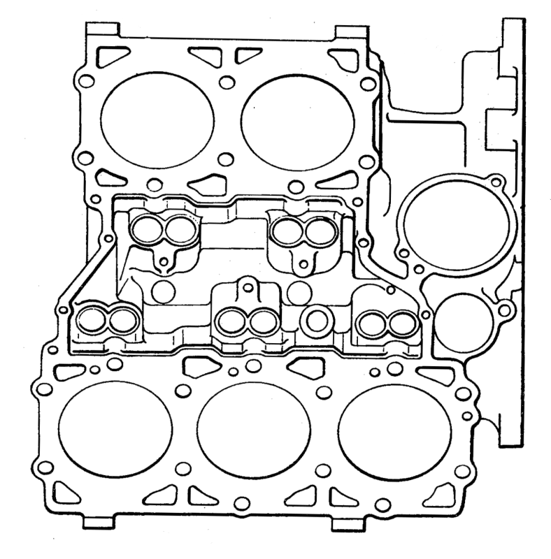

And they made a V6 version just to make sure to capture the worst of all worlds [lol]
In the case of Oldsmobile, they tried really hard to win this award but after a while it became apparent that although even more gutless than the V8, the V6 was somewhat more reliable (it blew head gaskets a little less frequently). So they had a third attempt and designed a 60° V5 engine (details in patent US4480600), and were well along in development with several cars running when the diesel market collapsed so it never reached production. The only redeeming feature of this engine was that it was the first automotive diesel with common rail injection (~1982), way before Fiat or Bosch (1997), and of GM's own concept (details in patent US4360163). These CR injectors used the outward-opening poppet nozzle that Dave was making in the SC factory while I was in the Detroit office supporting the application with Oldsmobile.

There isn't anything inherently wrong with a V5, Honda was quite successful with their RC211V engine.
