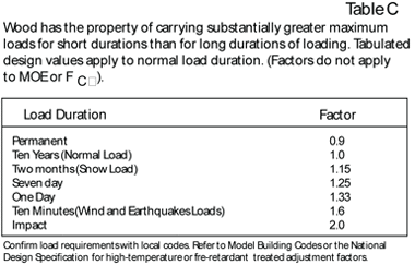

Concerning the 4 x 6 oversized posts, be sure to take advantage of the "Duration Factor" for short-term loading (wind) for wood. Perhaps oversized posts are not needed if properly treated 4 x 4 are used to prevent premature rot. You may still have a conservative design and get some cost savings, too, by using smaller posts.

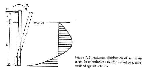

This number gives a triangular soil pressure distribution on the unloaded post... 200 psf at 1' depth, 400 psf at 2' depth, etc. When lateral load is applied, things change, a "short" post (this fence post qualifies) tends to rotate about a point that is between ground line and bottom of the post:
See the attached document for a summary of the calcs for Broms method of analysis of single (short) piles under lateral loading in cohesionless soil. Presumptive values (of anything) in building codes are conservative. If you obtain basic soil properties for the sand (unit weight and angle of internal friction), a higher value will likely be justified.
These calcs will give a value for the ultimate lateral force the post can resist... consider applying (or not) a suitable safety factor.
