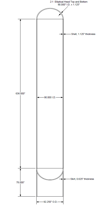

@ IDS, its ASME PTB-3 example 5.4.
From ASME PTB-3
Evaluate the following tower, Figure E5.4-1, for compliance with respect to the Type-1 buckling criteria provided in paragraph 5.4.1.2.
[ul]
[li] Material – Shell and Heads = SA-516, Grade 70, Normalized[/li]
[li] Design Conditions = -14.7 psig at 300oF[/li]
[li] Corrosion Allowance = 0.125 inches[/li]
[/ul]
Attached: STEP file.

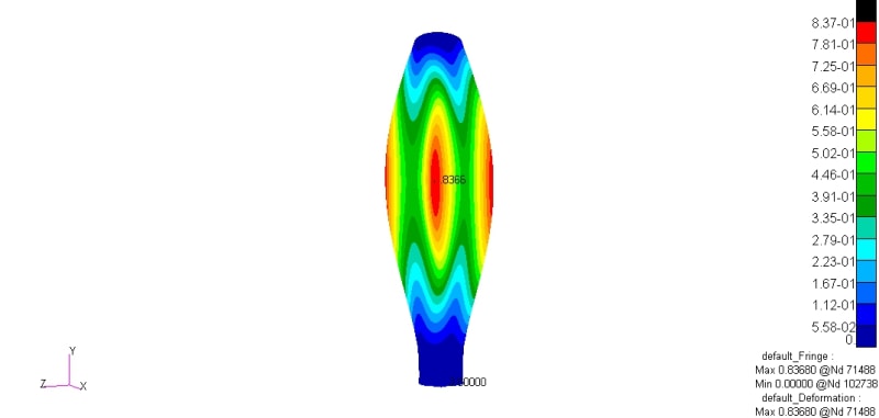

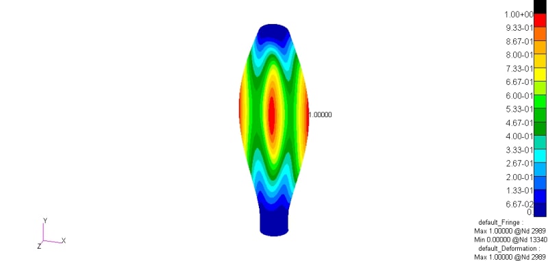

I have some first pass results done using MSC.Nastran. Used a 4-noded cquad4 shell element of size 2.5inches for a linear buckling analysis. Per the ASME example the static pressure load is treated as a pre-load for the buckling case and the buckling factors are calc'ed. The lowest eigenvalue (buckling load factor) is 10.918. I don't think the results using a cquad8 would be that different, but I'll give it a stab tomorrow (it's already past midnight my time!!). Here attached to this post is the mode-shape corresponding to the lowest eigenvalue.

Did the analysis using cquad8 elements with an element size of 2.5 inches. The lowest eigenvalue is 10.902 (10.918 using 4-noded elements of 2.5in size). The procedure is the same. Attached is the mode-shape corresponding to the lowest eigenvalue.
The static preload (obviously) has a big influence on the analysis. Without the use of preload and doing a regular linear buckling analysis the lowest eigenvalue is 11.902 which closely matches your ANSYS results (11.954). ASME ptb-3 (2013 edition) treats the external pressure load as a preloads to calc the buckling factor and thats what precisely been done in my models. I obviously can't vouch for the veracity of the 2013 edition as this is not something I use for my field of work day-in and day-out!! The mode-shapes that I have plotted above are identical to the shapes given in ASME ptb-3.
Coming back to you original question. You did mention contacts in your ANSYS model. Are you running it non-linear?? Or is your ANSYS run just a linear buckling analysis??Are you defining external pressure load as a static preload in your models across all packages you have used?? Are you sure that 8-noded shell is supported in a buckling analysis for inventor nastran?? You have discounted the SW results on account of its use of trias, so when compared with inventor nastran and the difference that you vis-a-vis ANSYS your answers to the above questions could provide some insight.

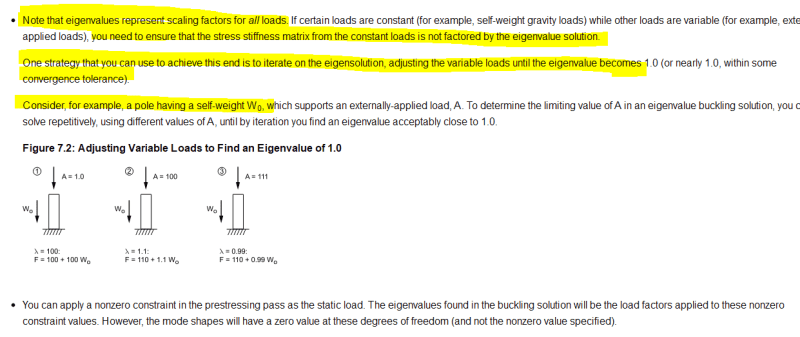

If I use linear buckling to iterate two loads (one constant prestress and the other variable perturbation) to get a buckling load factor of 1 based on the image below, Inventor Nastran is around 13% off the Ansys solution.
