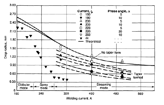

From ASM Handbook:
In streaming transfer, a well-developed liquid column extends from the solid electrode down into the arc and
breaks into small droplets before contacting the weld pool (see the discussion on spatter below). Streaming transfer can
involve 1000 drops/s, and the arc has a characteristic "cone" shape.
It all depends on drops/sec. In spray mode there are 100 drops/sec, while in stremaing mode 1000 drops/sec. In globular mode 1-10 drops/sec.
