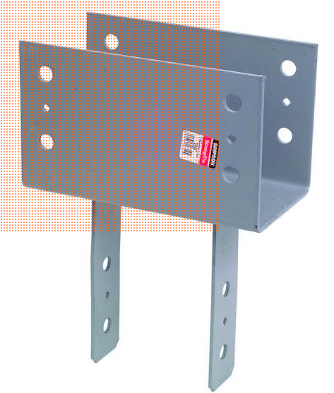

I am working on an addition to a building with a concrete block wall 12' tall. The owner would like to remove a 57' long wall and install three 8x8 wood columns with a four ply lvl (57' long) to support the existing trusses. The building is only 28' wide so the tributary width of the roof load is 14'. The columns will bear on an existing foundation wall. What is the best way to provide lateral support for the columns? I will call for a simpson elev. post base to be installed to fasten the bottom of the column to the floor and a post cap on top but how I can provide some kind of lateral support?

I assume you are concerned about out-of-plane beam lateral stability at the top of the column? Simpson makes some pretty heavy duty saddles that could be used. Seems pretty straightforward, unless the middle wall is a shearwall...

Quote (XR250)
....uh no. You actually have to brace the beam to something, otherwise the most heavy duty saddle Simpson makes is just a hinge OOP.
I agree that you seem to be removing a large portion of the lateral system however the building isn't that large and you can probably make the new south CMU shear wall work. I don't see a need for a moment frame.
As far as OOP stability of the beam, which direction are the trusses running? If perpendicular to the beam they can brace it (if detailed properly), if parallel to the beam 2x kickers (with strongbacks if necessary) braced to blocking at the roof diaphragm at whatever spacing you calc.
Bracing a wall or a beam to the roof diaphragm is pretty normal wood construction. Have you designed with wood before?

RE: LVL Beam on 12' tall wood columns.
Quote (Harbinger)
I feel comfortable using this csp to resist rotation. He could also just add some kickers from the top of the column to the rafters.
