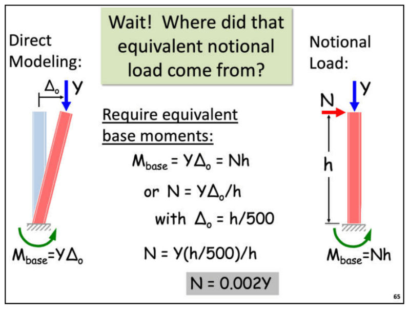

The derivation of the notional load for an assumed H/500 out-of-plumbness is as follows (from Ziemian):

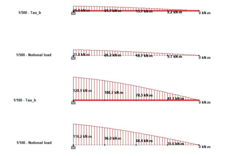

I was sceptical that the 0.001 load would be enough in the case of largish lateral loads so ran the cases shown in the image, hopefully explained well enough. The axial force is 70% of yield so Tau_b = 0.84. The length of the cantilevers is such that the axial load is 40% of the Euler load. I ran 1/500 (top two cases) and 1/100 (bottom two cases) notional loads for out-of-straight effects; and Tau_b vs additional notional load. For 1/500, the additional notional load is 50%, but only ~10% for the 1/100 case.
[Edit: Staad tricked me yet again by changing all stiffness back to 205GPa as is typical for steel rather than the reduced values - have I mentioned how much I hate this software?] I've updated the image above and the results are still comparable but whether Tau_b or notional load is more conservative depends on the magnitude of the other transverse loading, pretty much as you would think.

1) Derivation of Notional Load based on L/500 out of plumbness:
Ingenuity is correct about this in that the derivation of the 0.002 notional load (AISC section C2.2b, equation C2-1) is based on the L/500 out-of-plumbness and can be adjusted in cases where the use of a different out-of-plumbness is justified.

To me, this 3rd item is the basis of the OP's original question and I don't have a great answer to how this was derived. I don't believe that there is anything in the code that would prevent him from using this in lieu of Tau_b if the out-of-plumbness were greater or less than L/500. Personally, I would use the 0.001 value for any out-of-plumbness that is less than L/500 and adjust it to 50% of the other notional load if out-of-plumbness were greater than L/500.
But, I would want to check my 2nd order amplification factor. If it is greater than 1.7, then I'd want to do the Tau_b adjustment.... Heck, if it were greater than 1.7, then I'd want to change my structure and stiffen it up!
