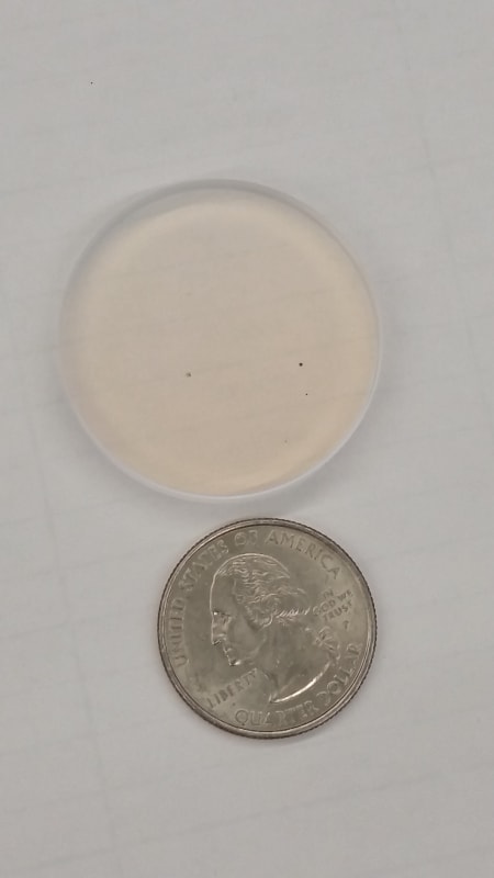

Like the previous closed thread, we've been having the same issue with HRPO .500. We are burning through glass covers. Between second shift and one hour into first shift, we went through nine lens covers. I saw in the attached thread that one person mentioned certain parameters for the pierce. Can anyone tell me what the parameters should be for my material? While I have general knowledge and I'm responsible for the division, I'm not an operator, so forgive my lack of technical skill when it come to laser operation.

burex2 - Appreciate the reply. This is on a 6K Fiber. The lens cover is a little different than on the CO2's. I've attached a picture with a coin for size reference.
hi, i know that fiber lasers have protective covers for the lens, unlike our co2, but since you have found contamination (splatter or dot) of the protection on the outside (if inside it was very serious), there are various causes that I can hypothesize since the only thing you said is that you found the lenses dirty. incorrect cutting parameters (during piercing or during the loss of the cut of a piece dust enters the head);

I ask if your machine when performing the pierce it creates a volcanic eruption with pieces of molten material flying through the air ??? if yes, it is a pierce problem.also you have to watch what happens when cutting. if it were just a piercing problem you just need to keep the pressure of the head at one bar and pierce 10 mm from the sheet. with 6kw you can make holes in the floor.
Is the capacitive height sensing calibrated and tracking properly? Watch the Z axis coordinates on the screen while it's cutting, those numbers should change smoothly

If it's bystronic it will be your parameters the delay for Pierce should be around .3 seconds also if your cutting material with coating I would raise the head alittle to. Tell me what material your using if your still having this problem.
